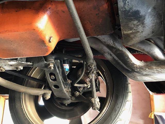

With the Charger, I do what I can to seal the valve covers and oil pan but still get seepage. THis picture is when I had the 727 but the condition continues. The RH header gets oil on it frequently.
I'd love to improve on this. Any suggestions? I have tried the one piece plastic windage tray and it leaked worse since this Milodon 6 quart pan is 1/4" shorter than a stock pan. I've heard of Superformance gaskets.....

I would try start with the pan rail to see if it is deformed, specially around the bolt holes tend to "bend" by too much tightening, flatten that out if this is the case.
I used the Felpro cork gaskets (incl. windage tray) and use a small layer of sealant on the gaskets and have had no leaks.
Another point to check is where the block, oil pan and timing cover meet on the front, that corner is also know for causing leaks.
A dot of permatex in that corner before installing pan and timing cover should seal.
By the looks of it you will be looking on the sides or front section since it's even getting on the headers.
Not sure if you are using a pcv valve on the valve cover?
Without pcv you will get a slight over pressure in the crankcase that can create leaks as well.

KernDog, your photo looks like rear main seal & maybe valve cover leakage. Both pretty common on BBs. My SB race motor too, but not much.
