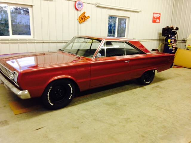

I am painting my wheels body color and adding dog dish hubcaps. Question is can i put 1966 Plymouth Fury 14" DOG DISH HUBCAPS ON NEW 15" STEELIES?
