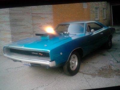

Here we go! bought this charger in june, was a quarter mile nitrous car that has set for the last ten years or so. my intentions are to take it back to mostly original, car seems to be pretty much rust free, was stored in barn as a race car for most of its life, looking over car most parts are there, wiring looks very good one repaint, original silver AA1 with black interior, racing stripe and vinyl top some bondo in rear quarters i think the car may have been wrecked, the only signs of rust are front dash which looks like surface, but media blasting in a few weeks will tell all. the 440 had a slightly leaking head gasket so after removing intake and heads found that motor has been punched 30 over cast iron heads valves are mushroomed a bit guides are a little sloppy, so i thought i'd put it back together, maybe drive it around a little so put it back together removed nitrous componets cleaned fuel system dropped jet sizing down, got it running pretty good. Test drive down road couldnt go over 25 front end a arm bushings gone, i would assume from racing so i decided to start the resto on it. but i still had a little fun in my driveway. starting project this week as my job will allow. will post pics as i go, wish me luck thanks.[video=youtube_share;z8TXTSfy1hQ]http://youtu.be/z8TXTSfy1hQ[/video]

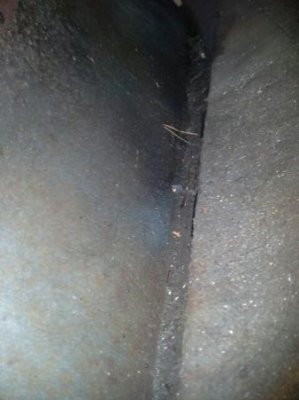

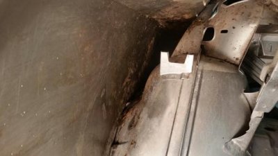

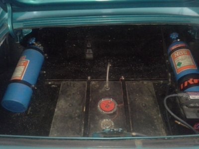

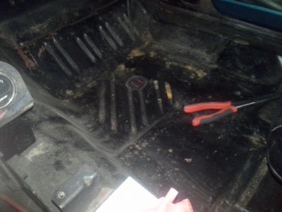

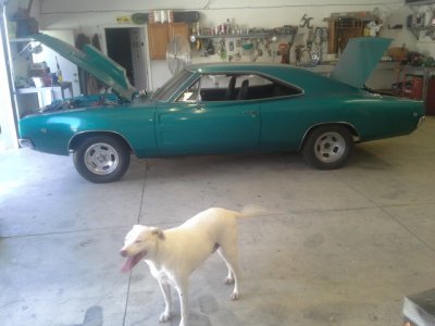

started tear down this week end removed fuel cell all trunk tail light trim etc. interior gone everything tagged and bagged, very little rust in trunk so far, all fasteners came out with exception of one bolt that broke couldn't get lube on it. pics are of the trunk with the nitrous tanks and fuel cell, side shot with trusty dog prince, inside of door, floor boards other door interior, and day one before i bought it will have better pics as i go. until next time....

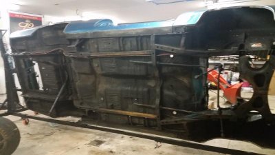

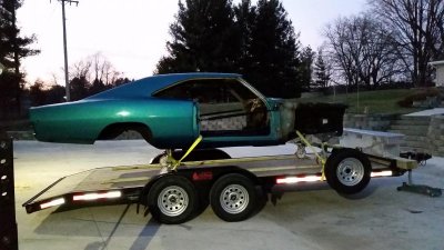

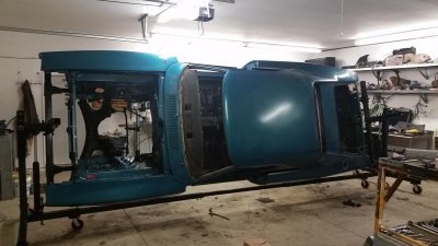

update just got car torn down and transfered from20141129_152659.jpg20141129_152716.jpg20141206_173339.jpg20141206_173356.jpg20141206_173400.jpg rotisserie to to cart for transport. Decided to have the car dipped in alkaline solution to remove all rust and paint, kind of pricey but will save tons of work. should have car back by christmas, a water based rust inhibitor will be applied to the bare metal so i can get the metal work done. then i have an appointment with a company that dips the entire car in epoxy primer. I hope to keep the car for a long time so i figured that should keep the paint from bubbling in the rust prone areas. will post more pics when i'm chopping it up for metal replacement.

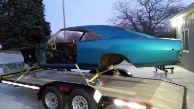

dropped her off thursday in toledo to have her alkaline. i got there and the guy says another charger! they said they have done alot of them in the past few years, they had a 71 pantera, already cleaned, and a 1970 charger rt next in line for the process. The alkaline is lot less aggressive on the car so they say, I have researched acid dipping and have read some horror stories about not getting it rinsed properly, and having seams expand, paint bubbling off, etc. i have heard nothing but good stories about this place, its called american metal cleaning in toledo, ohio. They have been in business for along time and had customers in and out while i was there. Its about a 10 to 14 day process, i asked them if he would have it done by christmas, he said he wouldnt give it back until he was done, i told him thats just what i wanted to hear. with that i told him i would wait for his call. here's a couple more pics. will post some more when its all shinny and new. merry christmas to all.20141210_172833.jpg20141210_172907.jpg

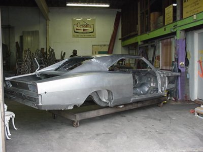

kind of pricey around 3000,(with doors,trunk,k member) i guess it depends on how far your taking the car down, and how valuable your time is, i work alot time is precious to me. plus i had a 66 mustang done years ago hard to get the media out of everything. And it did show up in the final paint a little. id have to say if it wasn't a rt it wouldn't be happening. but the dipping in the epoxy was quoted at 850.00 in my opinion u cant beat that. The place that does that is in elkhart, indiana. here's a couple of pics they sent me on a charger that was done earlier. I thought it was pretty impressive.68chargera.JPGDSCN5851 (1).jpgDSCN5852.jpg

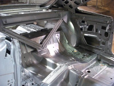

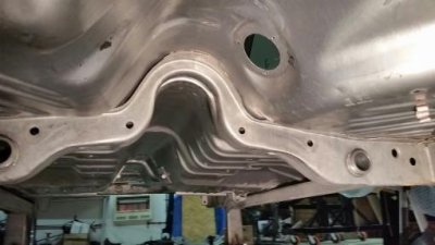

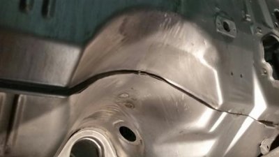

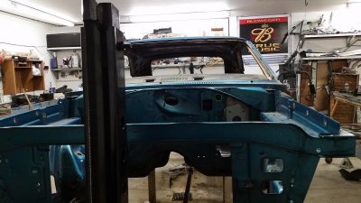

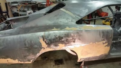

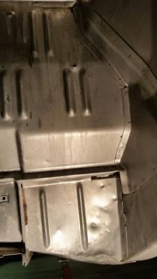

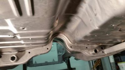

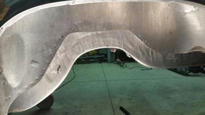

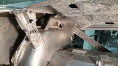

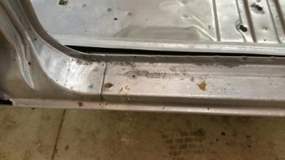

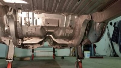

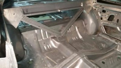

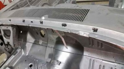

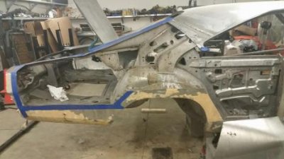

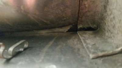

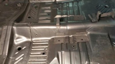

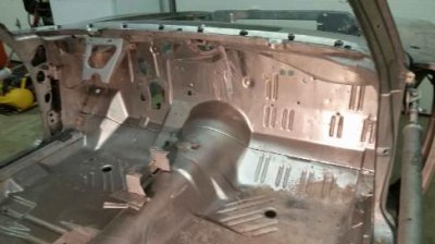

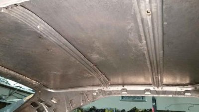

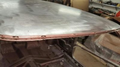

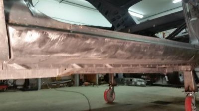

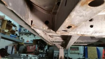

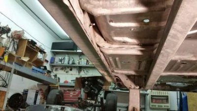

its back, quite impressed with there work. here"s the pics, hold on this is some sexy steel....20150120_110946 (1).jpg20150120_110946.jpg20150120_110955.jpg20150120_111003.jpg20150120_111015.jpg20150120_111048.jpg20150120_111056.jpg20150120_111119.jpg20150120_111126.jpg20150120_111143.jpg20150120_111209.jpg20150120_111230.jpg20150120_111317.jpg20150120_111339.jpg20150120_111444.jpg20150120_111501.jpg20150120_111526.jpg20150120_111810.jpg20150120_111914.jpg20150120_111957.jpg20150120_112032.jpg20150120_112109.jpg20150120_112326.jpg20150120_111628.jpg and not so sexy, you can see the patch where the guy brazed in a piece from another charger , actually a pretty nice job, probably back in the 80"s. checking frame for trueness and starting spot weld removal, many, many spot welds

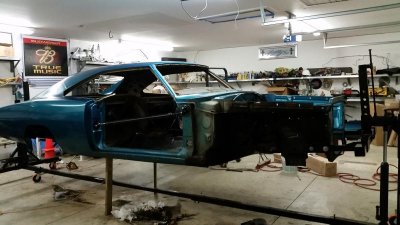

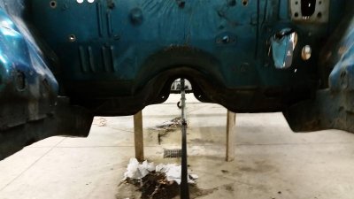

everything nice and true set car on cement blocks used my spectra physics construction laser, spun it level and straight line down center, reinstalled passenger door and fender, started cutting rear out, went to harbor freight, got there spot welder cutter, works great for 4$ as long as you keep it oiled, cut about 35 spots, still works20150121_151841.jpg
