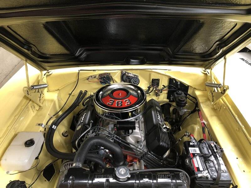

This baby with EFI would be the bomb!

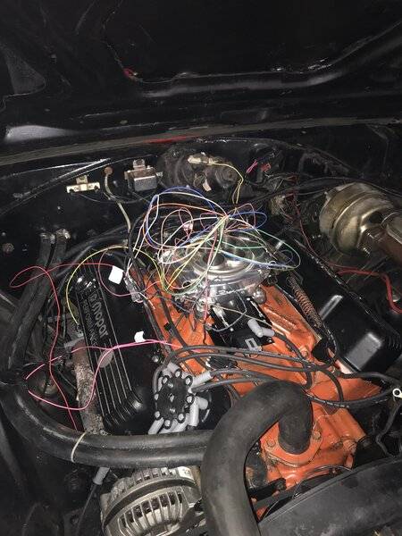

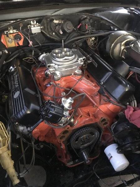

Im in the middle of installing the Hyper Spark addition to the Sniper. Its up and running I just need to dress the wiring up a bit. Had to do a few things prior to initial fire up. Update the firmware,and sniper software. Then punch in the engine parameters.. 8cyl,383ci,hyperspark ignition, wot timing and whether or not I'm using a power adder. Restart the Sniper and it fired right up. Then it takes a few minutes to get it to maintain an idle. But the more you drive the better it learns. That and with the ability for the sniper to also tune the ignition should be even better. This picture was taken when I installed the new cam.
This was the night I was installing the hyper spark lol. Storm came in and I had to tuck tail and abandon the project.
