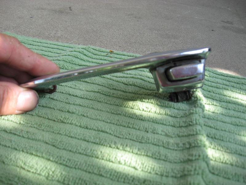

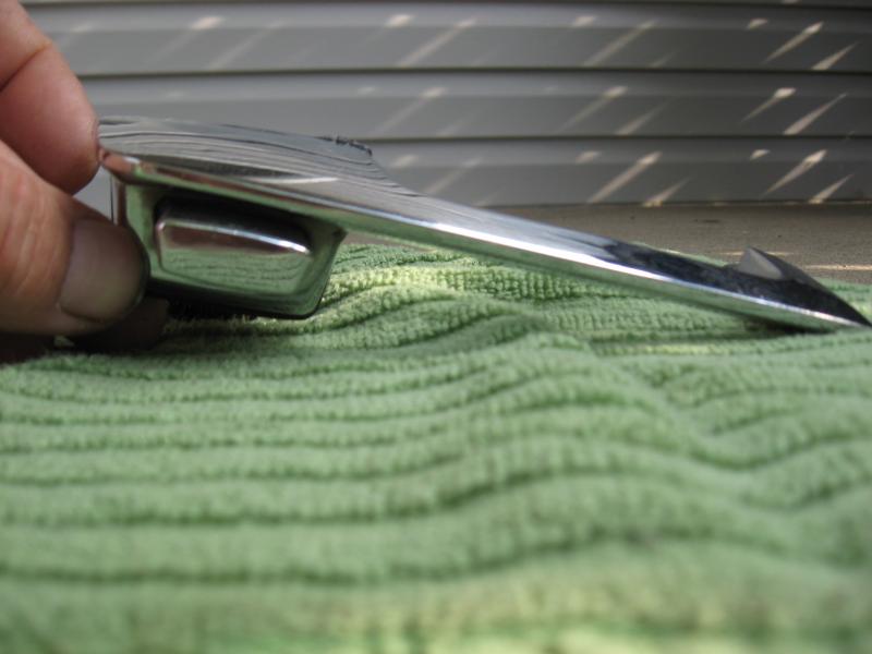

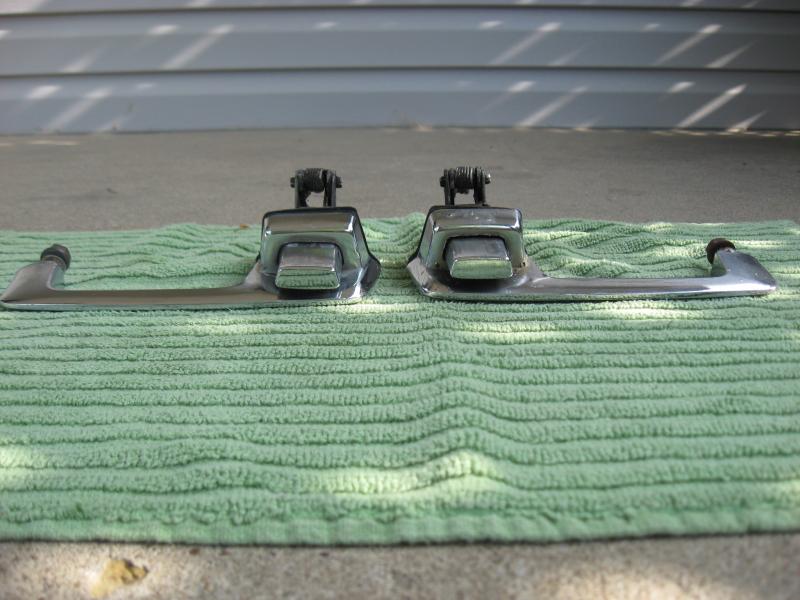

HI STEVE. ooops..... i have a set of exterior door handles from my 70 road runner. i think the 69's have the black button....these have the chrome button....anyway...i have a set here drivers condition ( very good shape...drivers a bit more worn than passengers ) ill post pix.....40.00 plus shipping and theyre all yours pay pal preffered

...... i think the 69's have the black button....these have the chrome button....
Early '69 Coronets had the black buttons. Late build '69's had the chrome buttons. I believe the switch from black to chrome was right about Jan. 1st, 1969.
My November 1968 built '69 Coronet has the black ones. My March 1969 built '69 Coronet has the Chrome buttons. Just FYI.
Steve, sounds like the screw that holds the button mechanism either was loose enough to pop off or stripped out. Check it out if it just was loose and popped off when you pressed in the button just screw it back in. If it's stripped you may possibly be able to retap it and use a bigger screw or something
100% Correct....Thanks......the handles seem to be brand new...and the screw had infact fallen out...all good now and I will be buying a spare set offered to Me by another forum Member...
