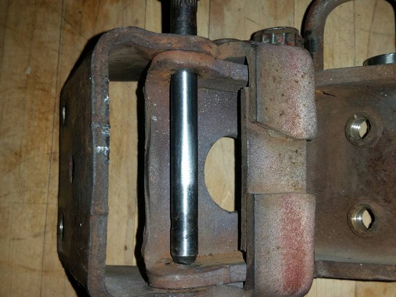

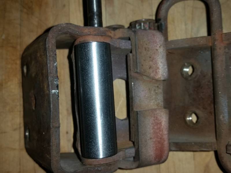

Or you can do Like I did to my door hinge pins . . .
Remember the fabrication that I did on the door hinges . . .
From this ( only (2) small 1/8" contact points )
To this with a new sleeve installed for complete contact . . .
Seems to make a HUGE difference on the door . . . or at least I'm hoping that it will . . .

So, you welded in support sleeve? With an ID same as pin?

Yes, that pic was before welding . . . Made a HUGE difference on the feel of the door stability too
