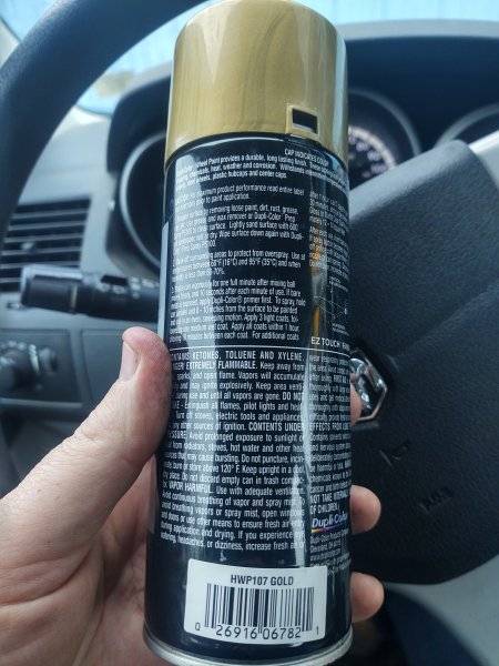

I found a duplicolor paint that was. Pretty close match instead of replating ...,
Yeah, paint just doesn't hold up the same. The type of person I am they'd be off every week being stripped and repainted !!
