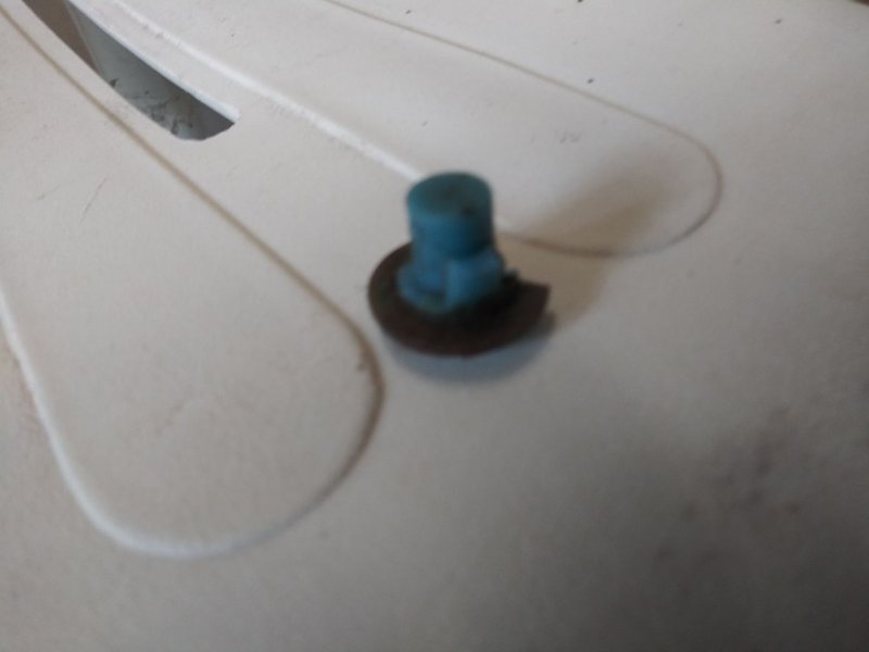

thanks dako, got it apart, the plastic push clip is broken, the piece that holds the the window to the lever ? where can i get it ??? many thanks for your help, will post a picture soon, ed
put the window together today, looks like that plastic revit is going to pull through again, any one try that plastic bolt with a nut ???
