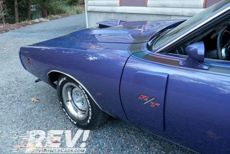

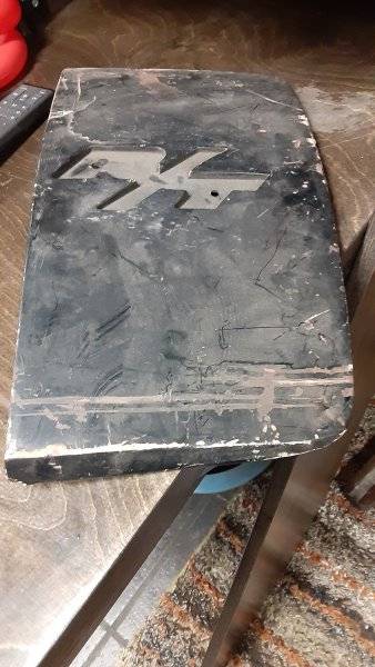

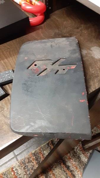

I'd love to find a source for the door scoops without the inset.
