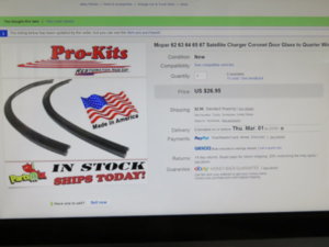

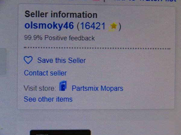

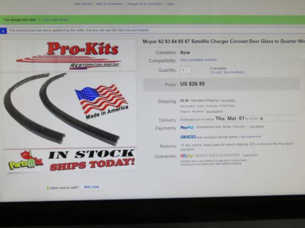

I bought these on Ebay recently, they were perfect. Made of rubber like the originals (not flocked material). They installed easily and seal correctly.

I just disassembled, rebuilt, and installed two 66 Charger quarter windows with regulators. The original windows, plus two others I kept, have the plain rubber seals (shown in the picture in the previous post). I bought the flocked type before (accidentally) --- they need heavy modification (trimmed through the entire length) to fit. I never did get a great fit or cosmetic result and ended up replacing them with the plain rubber type. I'd love to see a picture showing the cross section of both. Also, appreciate the tip on the Steele roof rail rubber. I've got to replace that soon and don't want to pay for another "lesson learned".

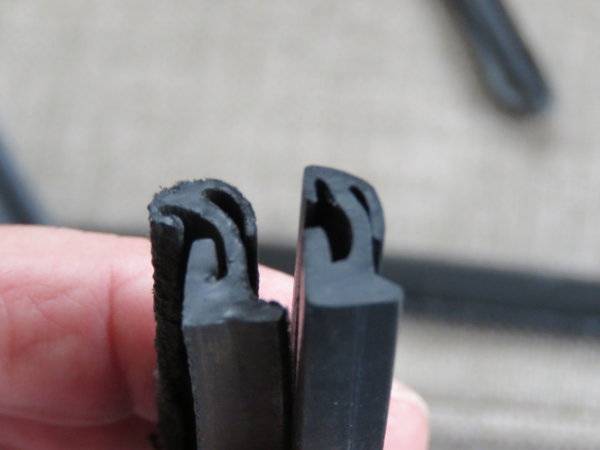

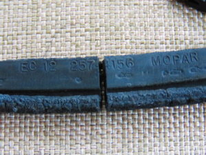

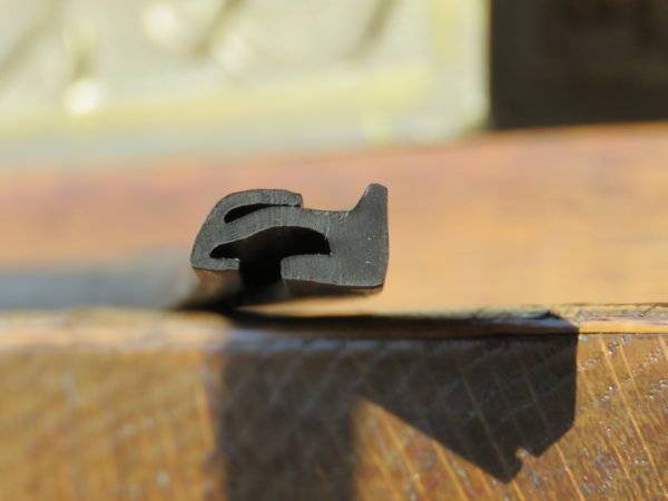

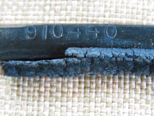

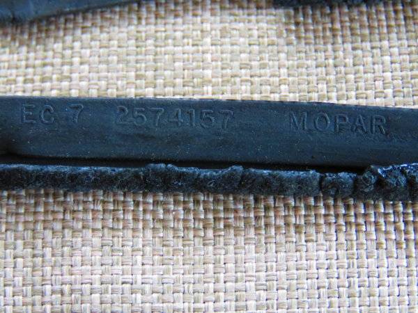

I pulled the original 66 Charger quarter window rubber seals out of the trash. One of the pictures below shows a cross section comparison (the original to a metro). The metro fit beautifully and is very close to the original. I also noticed -- it looks like the originals weren't universal for both sides. One made for the drivers side and one for the pass. side. Below are pictures of the part numbers. The EC 12 2574156 was on the pass. side. The EC 7 2574157 was on the drivers side. Both had the numbers 910440 on them.

The part number reference is that the original Chrysler pieces had a small cap bonded to the profile to give it more of a finished edge. Thus the need for a right and left application. Over the years, many of those caps broke away as the quarter glass wore out and it fell aside. Fast forward 50 years and the reproductions do not have this small detail. Some of the various Soft Seal pieces do, but varies depending upon application. Finding NOS quarter glass seals is comparable to finding that needle in the haystack.

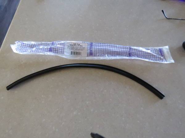

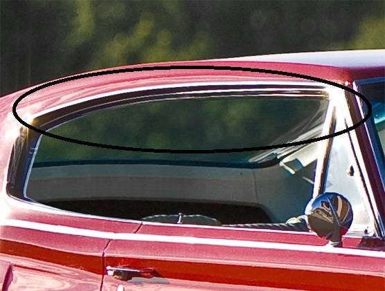

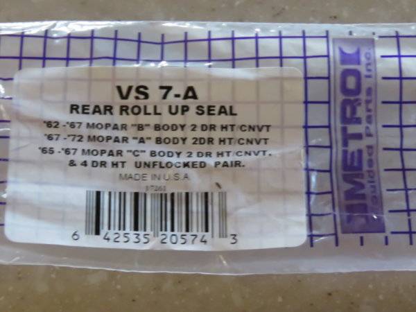

OK, I'm a bit confused. I am looking for the seal that meets the window when you roll it up on a Charger (67). It seems to have referred to several ways here and is what is confusing me.
Is the VS7A the strip that I am looking for. If so I found the at Tamraz for $20 but says quarter. I need front to back on the roof.
Seems to be one piece so how can it be quarter?

I believe they are trying to use those as the rollup seals.
ODZKing, you have circled the roofrail weatherstrip. The best sealing weatherstripping for the 66 to 67 B-Body is the Steele piece. They allow for a much better seal than the competition. The other major difference is that the Steele piece is almost twice the price. The quarter glass seal is the seal that attaches in the stainless trim at the back edge of the door glass. This seals the edge of the quarter glass to the door glass when both are rolled up completely. Both Metro and Soft Seal offer a comparable piece at similar pricing. There is a cheaper variety available and has a correct profile, but it is not flocked and all of these seals after 1962 was flocked.
