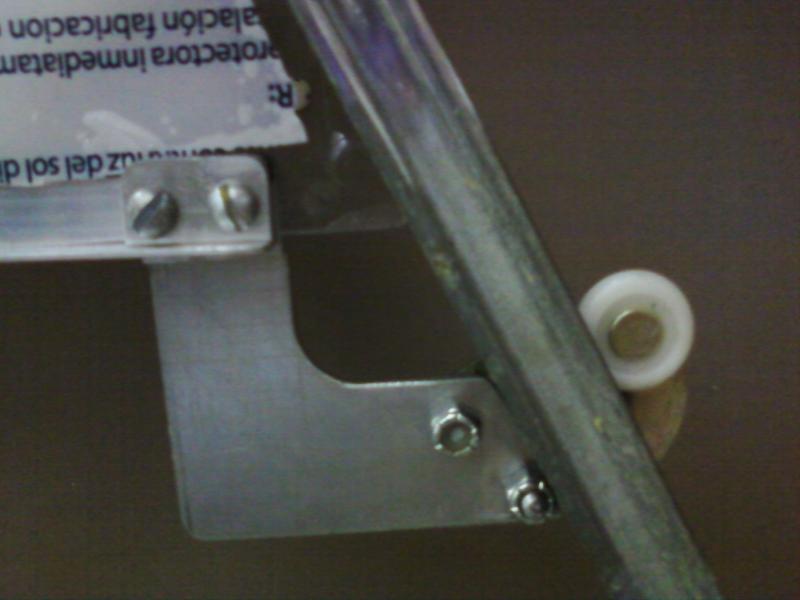

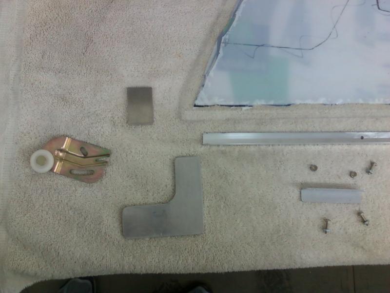

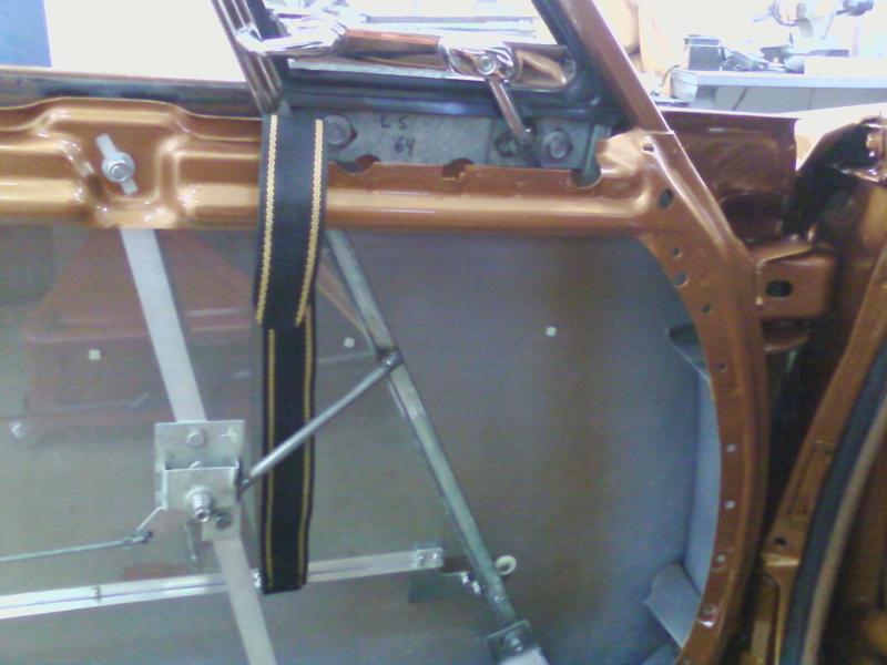

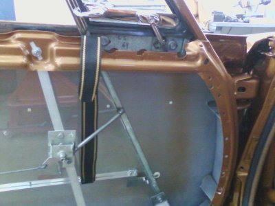

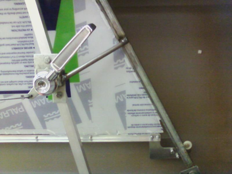

I thought about doing on my 64 Belvedere post for weight reduction. Once I got into it there was more to it than I thought. The window goes forward when it goes down. The vent is the track so it would require a new front track . I'm not sure there is enough room for the window to go forward in the door which might require a new rear track as well. Here's a picture of the inside of mine with the track modified to keep 1/8" Lexan square in the track.
Doug
