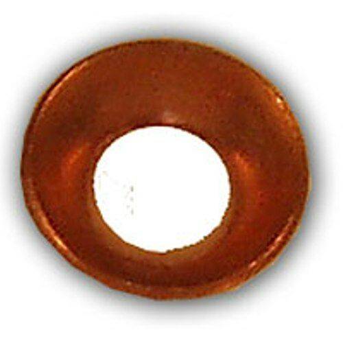

Is the tubing soft, or is it stainless, which often has problems because it's so hard? If there are no cracks and it just won't seal, you can try adding a soft copper washer.
https://www.ebay.com/itm/3-8-Copper...soft-copper-line-water-air-fuel-/381165667616
I agree with this. I was talking with the guys at the shop who are working on my car. They told me they have had A LOT of problems getting stainless steel brake lines to seal because they are so hard they don't move enough to conform to the mating piece. He said they've tightened them until it deformed the mating piece, and still no seal. We chose to go regular steel lines in mine instead of stainless.
The soft copper washer sounds like a good idea!

Yea I was thinking that too you can feel it grabbing as you turn the nut. I will give that a try tonight. Also ordered a few of the brass cone washers.
