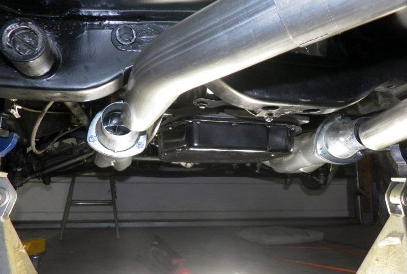

is this typical with headers and exhaust pipes fitting?? are there angled reducers?
Yep pretty typical although that driver side looks a little worse than some. No angled reducers that I am aware of. A little creativity needed.
Wonder if the flange was welded on crooked? Seems like that header should be more to the right.
Get a coat hanger and form it to the back or inside radius of the angle your needing and take it to an exhaust shop, they will probably bend what you need for the cost of a scrap section of pipe.
I think I paid like $15 for two pieces to be bent for my wife's car. Or you can order a present 30 or 45 deg piece online an cut it the way you need.

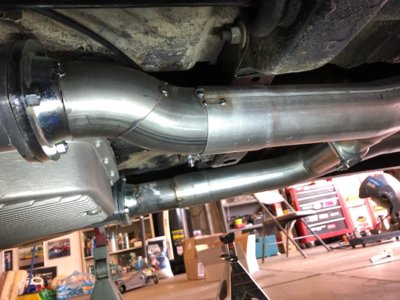

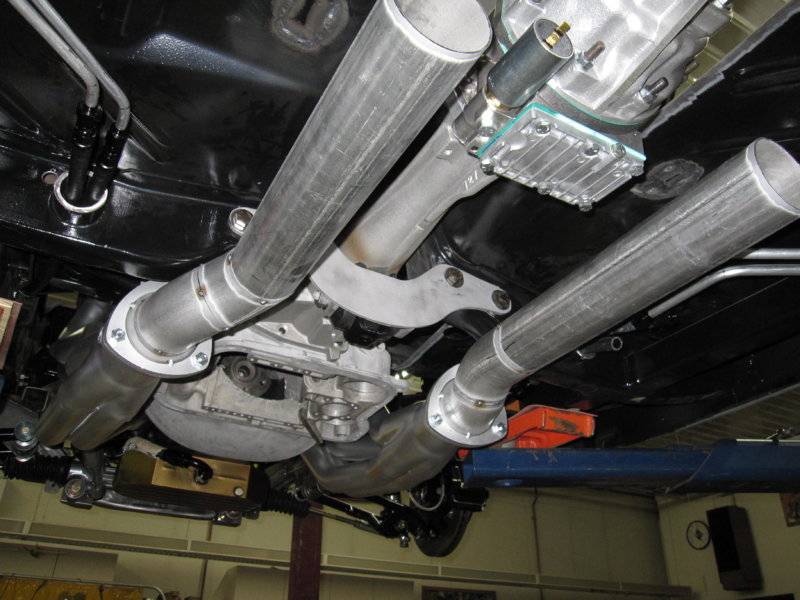

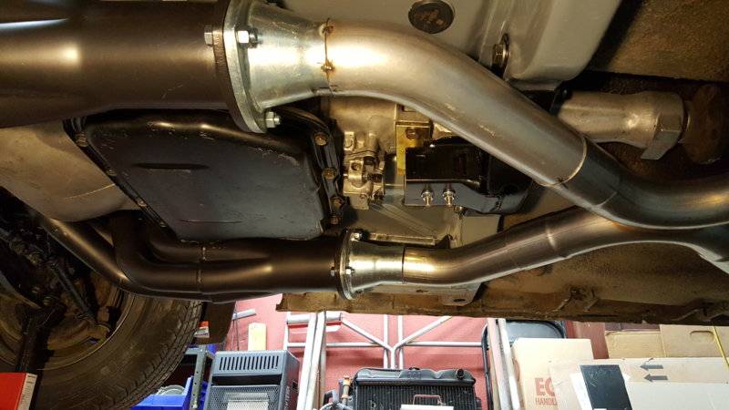

I used the Dougs and they or probably any header won't line up with the curves in the cross member. You can see in my pics how you can get around this...

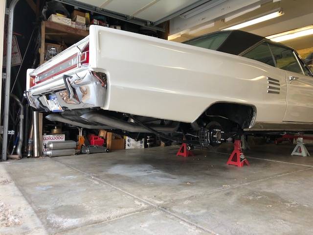

Doug’s D452 headers and tti 3 inch H pipe exhaust. Came out fine, runs great!
F678BA00-AD26-402A-B463-834C7C1E7AD3.jpeg A1BE22C4-F3D1-4607-BB10-FF2C9EB776F0.jpeg

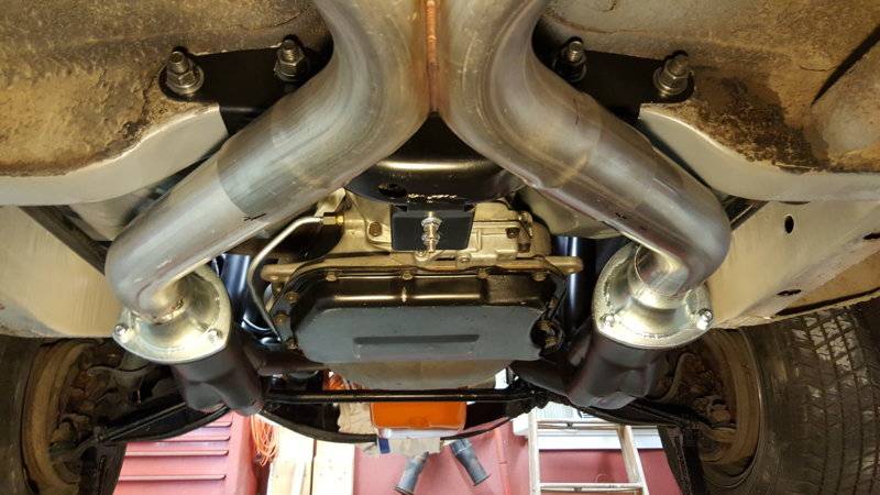

If you have an H-pipe add some tube to cross over pipe. Bought a TTI headers back system added a small piece. For me it was easy since cross over was slip fit.
