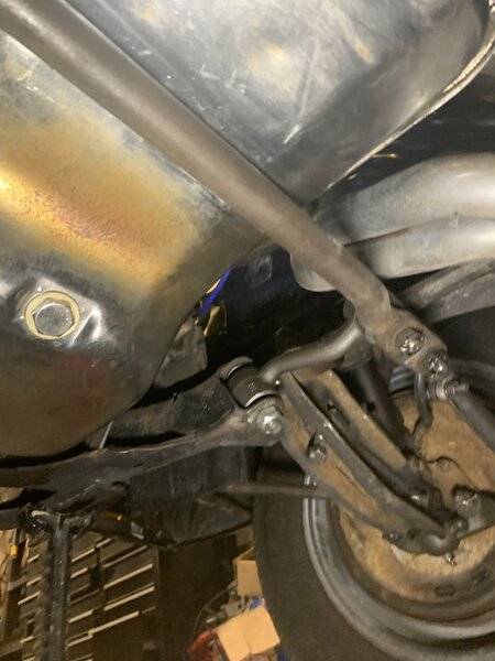

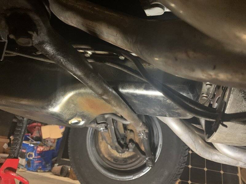

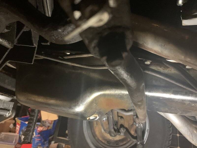

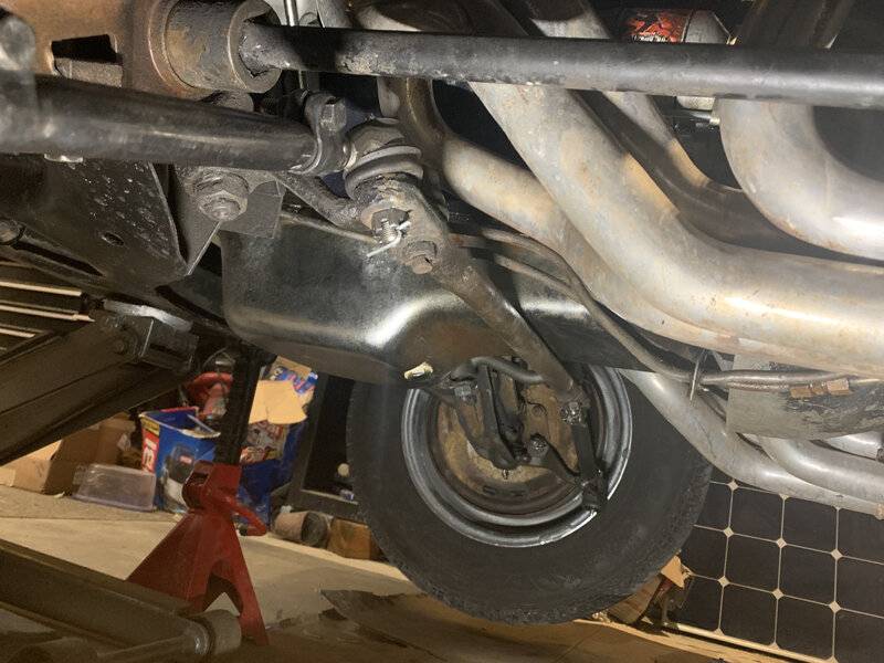

Drag link on my 68 GTX is rubbing oil pan...
New Idler arm looks shorter than Pitman
Is there a drag link with more clearance ?
Maybe oversized oil pan?
Just acquired this car
Anybody ran into this?
Possible wrong oil pan. Pictures as requested.
I’ll get some pics tomorrow. It is a chrome oil pan
It's probably incorrect. It can either be a rear sump, a center sump or a front sump, depending on the application. Wrong pan will cause problems.
Thinkin the same. I’ll get you a pic. See what you think
Not big on chrome pans. Seem to leak on me
check the rubber motor mounts.
I was looking at that possibility
if I remember correctly there are a number of idler arms that will fit but not give you full clearance
A fast ratio pitman arm can be another cause
All things for you to check as you rule things out
Bear with me replying and posting pics
Pics don’t show too well but idler looks shorter than pitman
