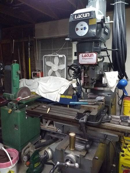

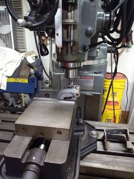

And I'm thinking the larger machines are pretty cheap right now with the oil markets being so dead right now. Been awhile since looking into them but bought my clone new back in the early 90's because all the used and abused Bridgeports were priced to the moon at the time. Probably would be lucky to get 2500 for it during these times....

Oh, Cranky, Lagun is a nice machine.. $2500 for a machine that has been personal use since new? Sign me up....
