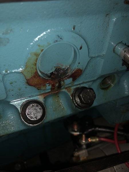

I think I found the culprit. It took some work getting to it. First I had to remove the header. To do this, I needed to remove the spark plugs, unbolt the left motor mount and jack up the engine on the drivers side so the header plate would clear both the steering gear and header bolts. Once I got the header off, I found this. A freeze plug that has been leaking. The logical place for the leak would be around the outside rim, but it looks like it actually has a pin size hole in the center. I hope it comes out easy. My question is...should I put sealant around the outside rim before installing the new freeze plug? And if so, what kind of sealant would irk best?
Thanks!
They NEVER leak around the rim.. other than initial install weep. They rot/rust through from too much water and not enough antifreeze. Permatex non hardening around the outside flange and knock the new one in with a socket the correct diameter. Do ALL of them on that head while you're in there.. worth checking the block with the headers already out as well.
WoW! You said it was a fresh 440? I don't know about that! Now you have me worried!
A habit I got into, on my engine builds, was to use Indianhead Shellac on the freeze plugs. I 'paint' a coat of it, on the sealing edge, but also on the inner surface. That seals, and protects the freeze plugs, from water corrosion. These days, I always use brass freeze plugs, but still do the same thing.
I suppose Permatex could work, too.
Problem solved. Freeze plugs replaced and leaks stopped. Now onto the brakes and parking brake
