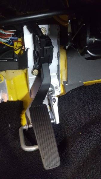

So I'm pretty much running same combination, Just not quite done yet. I used part of the old pedal assy using a lokar kiskdown cable and fabricated up a bracket to mount new pedal(see Pic)
It seems to work quite well. Also Bouchillon performance came up with a kit based on the 02-03 ram pedal you can check with them.. Good luck with yours!!

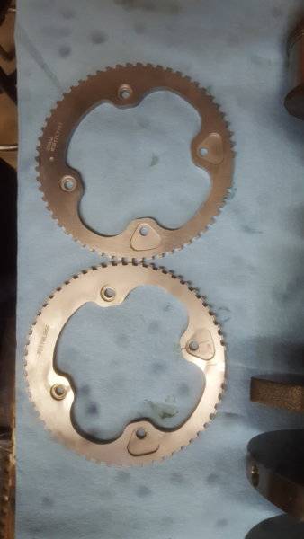

Mech440 - did you change the tone/reluctor ring and sensor to 2013 or later as well? And did you re-balance the crank with the new ring? Some say you need to some say you don't?
Yes.. I changed the tone ring... No I did not rebalance crank. I read the same thing you have some say yes.. some say no... I did not and can say I've had no ill effects and while I don't have a calibrated butt as some have said you would need, I've felt no crazy vibration at any RPM. And yes I've revved it quite a bit this past year...LOL
yep I did change the sensor... I ordered the tone ring and sensor for the 2014 motor...As for as difference in size? I believe the difference was in tooth count not actual "size", See attached pic of tone rings... Hope this helps.
BTW... Yes you have to pull the crank out to change the tone ring.
