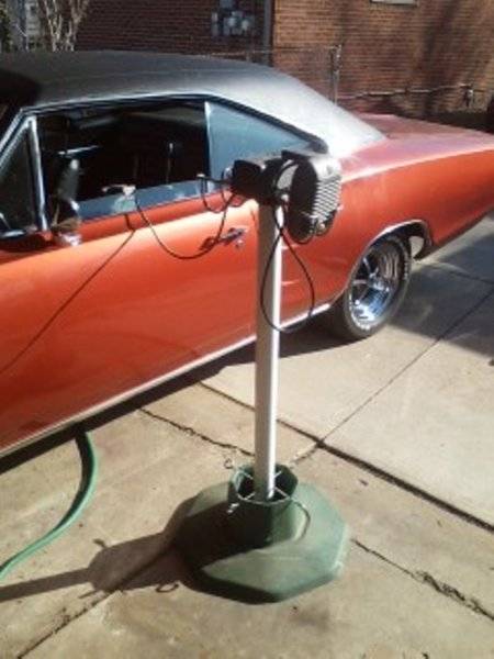

A few weeks ago I bought a pair of speakers with the holder at the Michigan Antique Radio Club swap meet. They are stamped as being from the Starlite Theater in Bay City, Mi. I used a length of PVC pipe for a post, and a tree stand for a base. My plan is to display them near my car at shows. I had to replace the speakers and the cords. I would like to install some kind of audio source to play music through them, car themed songs. I am going to paint the post and base black. Here is the result so far.

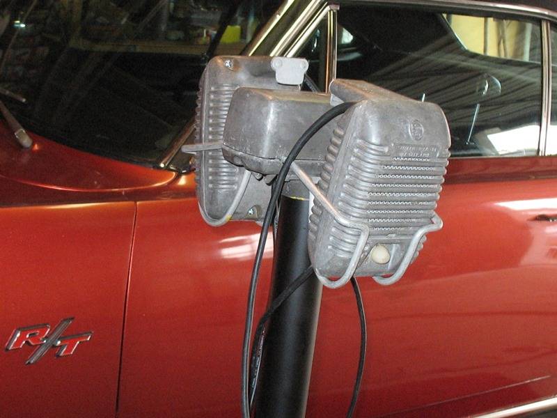

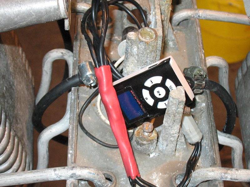

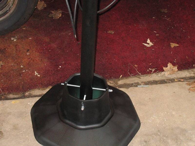

I have been working on the speakers. I bought a small, cheap MP3 player. I replaced the worn out original speakers. I wired the speakers up to a jack to plug into the player. I painted the pipe and stand black. I ran threaded rods from one side to the other through the pipe and stand. I downloaded 30 car songs onto the player. Each speaker is hooked up to one channel, so the sound is in stereo. The third photo is with the top off showing the wiring and player. To charge it or add songs, I just unplug the player from the speaker jack.
