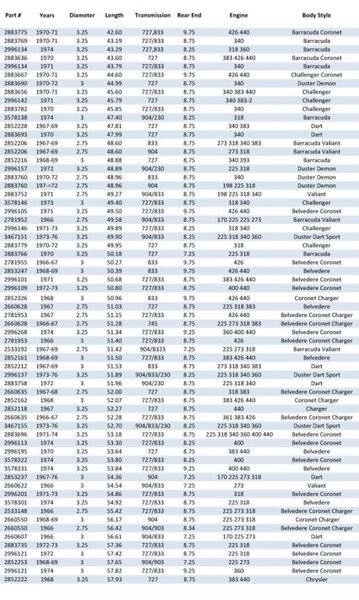

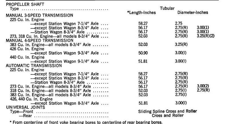

Does anyone know what length drive shaft a 67 Coronet w/a 727 & Dana? It's Sunday & too dang hot and late in the day to go to the shop to measure. Would it be the same as a 65 Belve by chance?
Thanks
