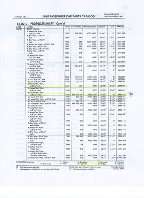

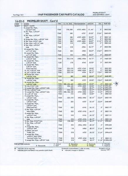

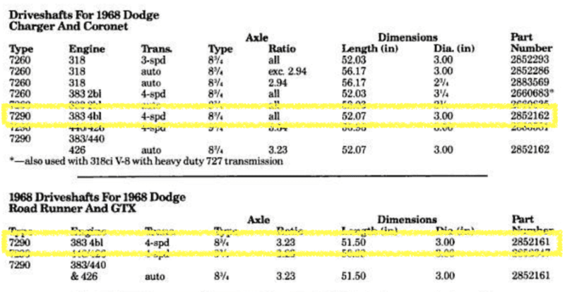

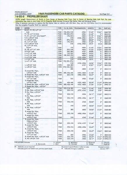

Here you go from the Factory Parts Manual for 69. Also how they measure shaft length.
Ah! Excellent information. Looks like the larger drive line I have is from a Slant 6 with a three speed. I guess I'll use the yoke off the skinny one that fits the A833, with one of those combo u-joints and have it shortened to 52.07 inches. It also looks like the A833 and the 727 used the same length so maybe I could find one locally. Anyone? Spokane, WA
