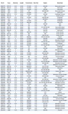

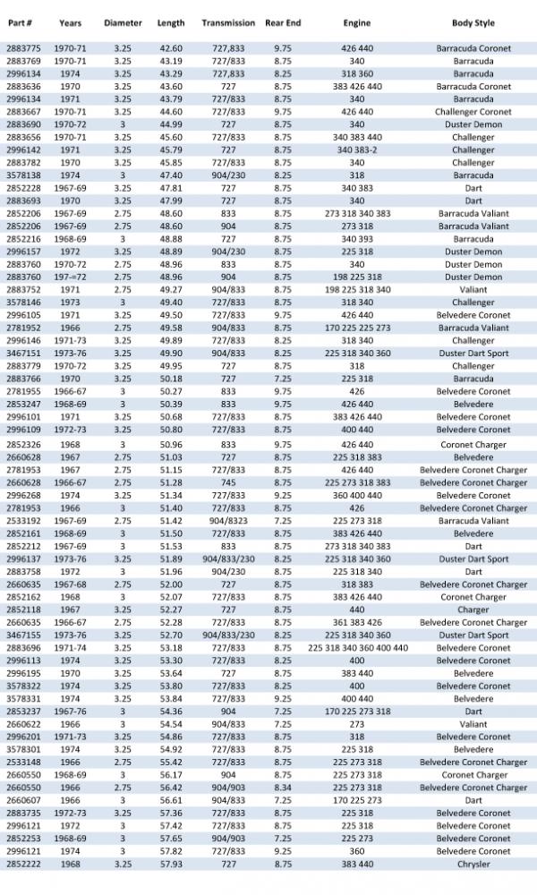

67 belvedere 1 ... changing over from slant 7 1/4 904, to 400 727 .. 8 3/4 rear. anyone with length of driveshaft center of u joint to center of u joint?????? thanks
Here's a link to drive shaft chart. Put a 51.25 in my 66 Satellite 727 looked to short. I switched to a dana 60 30 years ago and removed it last year to go back to the stock 8.75. Over the years I picked up another drive shaft from I believe a 66 Charger. I didn't know which was which. So I put the 51.25 inch in looked to short. So I put the other in,52.125 appox length.
http://ccc.informe.com/forum/engine...n-f15/different-driveshaft-lengths-t4527.html
