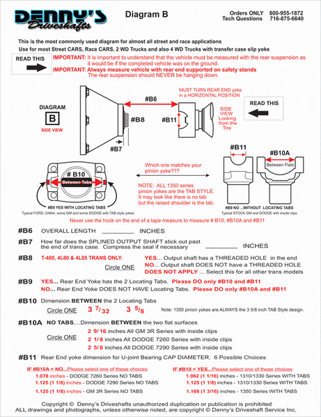

I think you will need to let them know a little more info about your car...
The best way is to just measure between the points in diagram B7 the measurement you need it #B6
read the above
you need to specify if you have the large or small ujoint and check to see if both are the same and that each side of each is the same or if one side large one side small let us know
get genuine spicer u-joints with the grease fitting in the cap especially on the small u-joint

I will try to do 2 counts with the table above
