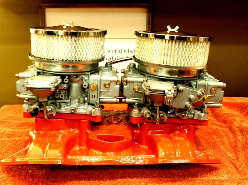

One thing is, will there be enough room for 2 holleys end to end.
When I put dual Holleys on mine I needed offset spacers.

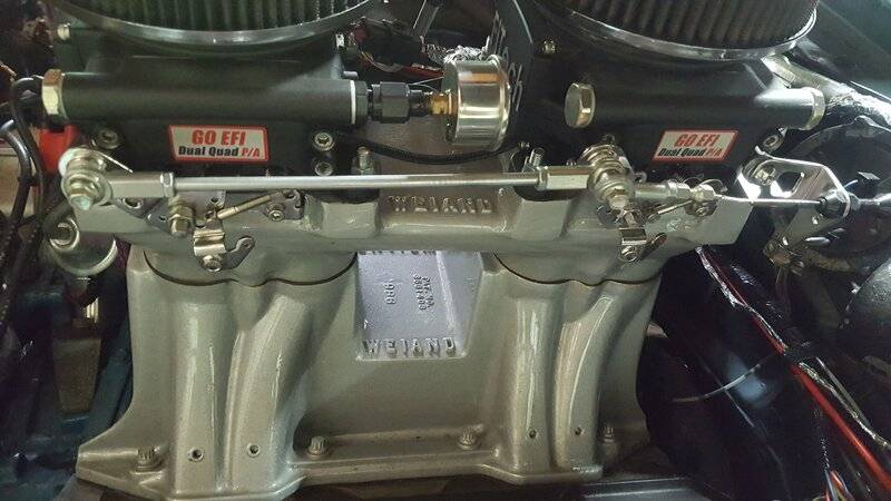

I have a tr, ran good with 390s, ran great with 600s, both vacuum secondaries, then efi.
Never had progressive linkage.

Thanks for your question. The intake has mounting plates so that I can turn them sideways if necessary. I uploaded a photo of how he had them mounted on his intake which is the same one that I am using. 1850 Holleys are pretty much square-shaped.

I have plates mounted on the intake so I could mount them sideways if I chose to....please see the photo that I posted of them mounted on the same intake that I am using.
I did the same. Some heim joints and 5/16 rod. I also welded a tab pointed down at the right location for trans rod.
