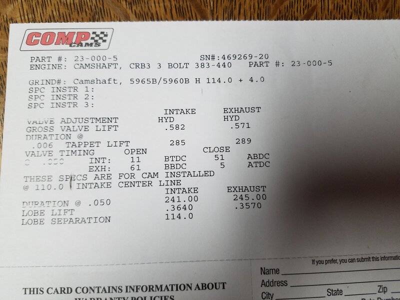

Is that really where you want the performance? What camshaft, converter and gear are in it?
Yes it is. I want the torque down low for a fun street car. All the specs were given to the builder before before starting. 69 Bee, Hemi 4-speed, Strange 60 3.23's, 28" tall tires, Quick Fuel Q-850, TTI headers to a 3" full exhaust, Trick Flow 240's. Car has a Ramcharger hood, so he slightly ported/modifed a Weiand Action + for hood clearance. He told me the 600 ft lbs the motor puts out will make up for the bottleneck of the intake no problem. It sucks imo. I picked up a Edelbrock TM6 and have a line on a Holley Street Dominator. Both shorter single planes that I can get under my hood. I am going to try one of those this spring.....

Do you remember where that Cam C/Line was installed or the final psi targeted for the 3.23/28" tall ?
Seems strange the 493 would dis-appoint down low ?
