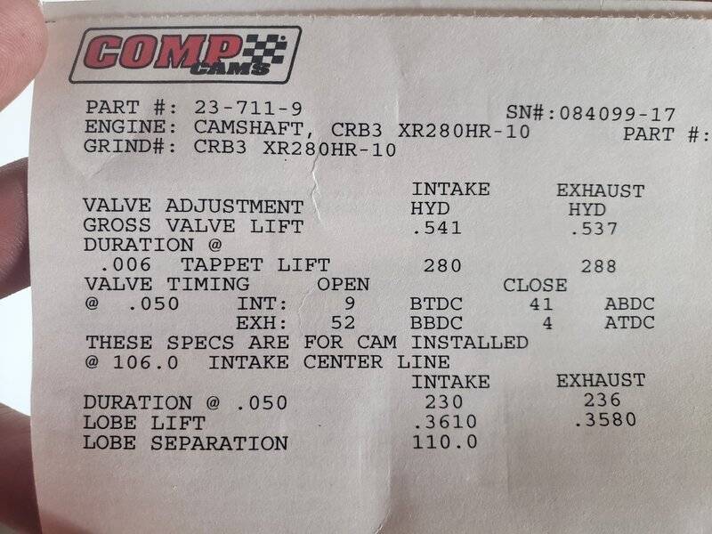

I followed this build only using my 383 to 496 w 440 source. I used the Comp Cams hydraulic roller instead of the hydraulic flat tappet.
https://www.motortrend.com/how-to/chrysler-383-big-block-mopar-for-the-masses/
How do you like that cam? I used the next size up 236/242 @ 0.050" in the 505" stroked 440. It seems mild the the 505" engine, but I was looking for mild / torque and EFI friendly. I can run the car in overdrive (5 speed manual) at 1,500 RPM @ 60 MPH is no problem.
Unfortunately, I didn't look into all the parameters of it before purchase. On the engine dyno, it was great. In the car in the real world, detonates on 91 unless extremely retarded. Used a Cam computer program recently. Even w 10.2:1 compression n aluminum heads, it's got 190 cranking pressure and 9.7 dynamic. Had I known about these things earlier, I would have gone w a cam w more overlap. I am running 3.73's w 26" tires. W Gearvendor o/d, I'm turning 2,800 at 70 n 3k at 80. Only get 9.5 mpg w fuel injection running 14.7 afr while cruising.
