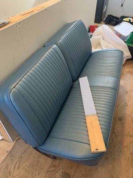

I have a 66 Belvedere with blue vinyl seats that were recently upholstered…..want to change to white or black
How does it last over time? Does it come off eventually? SEM seems to have the best stuff to make this happen…comments? Thoughts? It’s not a daily driver
I will second SEM with an adhesion promoter. Scrubbing the seats thoroughly clean is also critical. There are two SEM blocks to consider. Landau black has slightly more gloss than SEM Satin Black. I prefer the Satin Black on vinyl and plastic parts but I’m not sure about for soft vinyl though.
Another option if you have a compressor and spray gun is to go to a PPG dealer and have him mix up some matching PPG Elastomeric Vinyl Paint. It’s usually mixed to spray right out of the can in my experience. Might be a better choice for something as large as a seat, but SEM is an excellent product.
I would not personally risk a color change painting/dyeing a seat. But others have done it successfully so there you are. On something as large as a bench seat, rattle cans are not the way to go IMO. Use a compressor and gun and purchase PPG elastomeric interior paint and do it right. Follow their instructions carefully for cleaning, priming and spraying.
