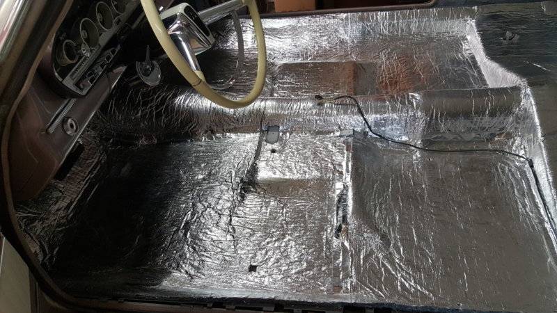

I used Noico from Amazon. Cheaper than Dynamat and it looks to be the same stuff.

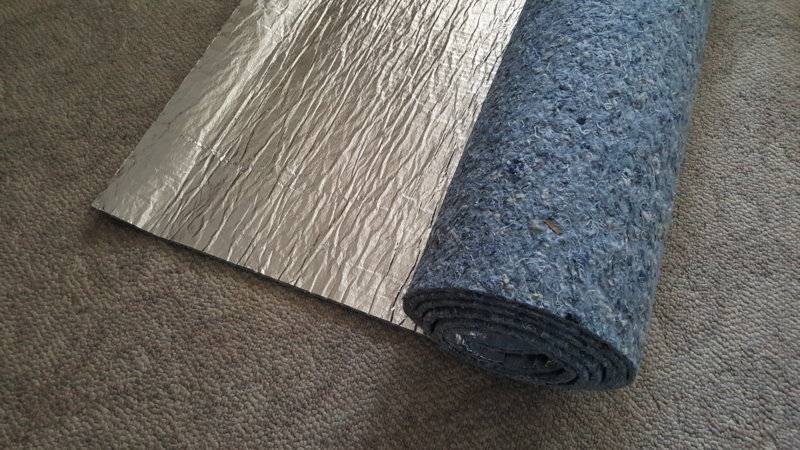

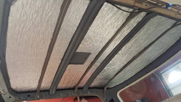

Same insulation that I used on the roof. Made with recycled blue jeans. No itchy scratchy. Flame resistant. Fairly easy to work with.
https://www.homedepot.com/p/UltraTouch-48-in-x-24-ft-Radiant-Barrier-30000-11424/100661257

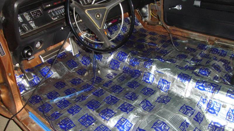

as did i worked great and 1/2 the price if i remember right and 1 box was enough to do the floor inside the car from the trunk divider to the heater box area.

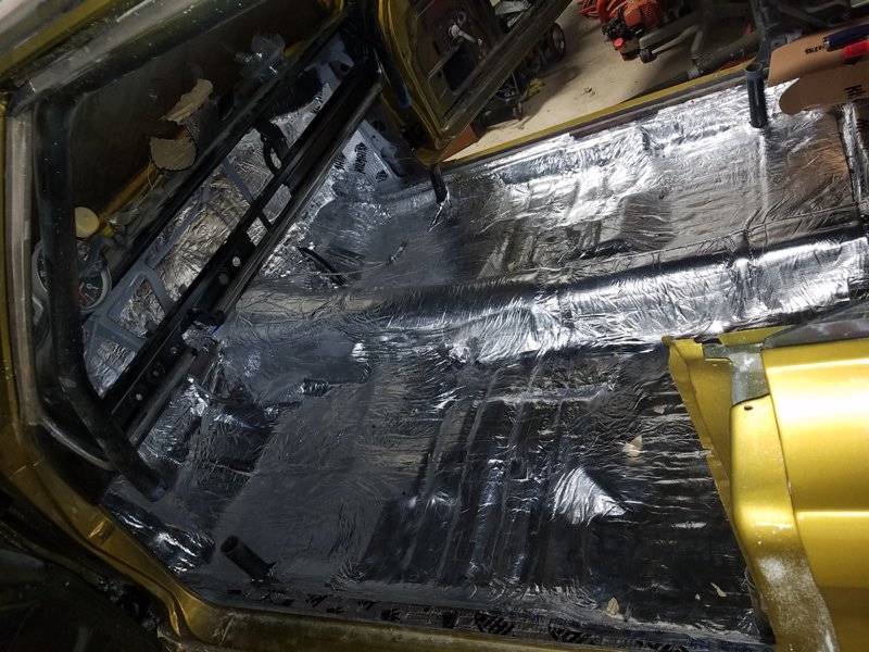

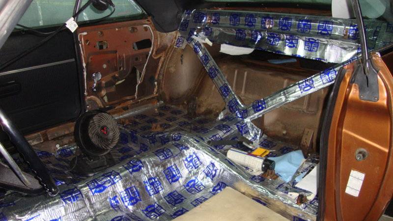

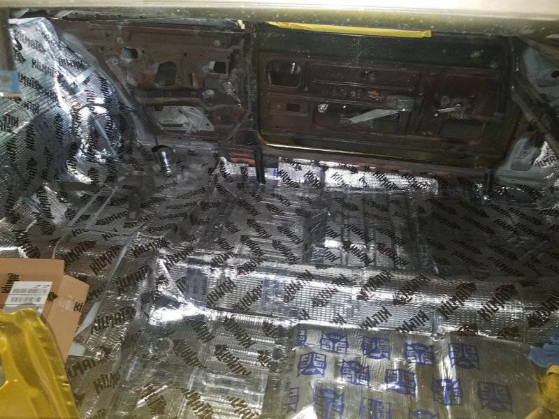

I used 'mega-mat' from Fatmat. 50sq-ft roll was around $125 and did all the way up the firewall to under the back seat. Had leftovers to cover the bottom of my package tray and some under the dash.
Note: I don't feel it necessary to cover every inch and have a perfectly gapless installation, with the exception of over the exhaust pipes and firewall so that helps it go a little farther.

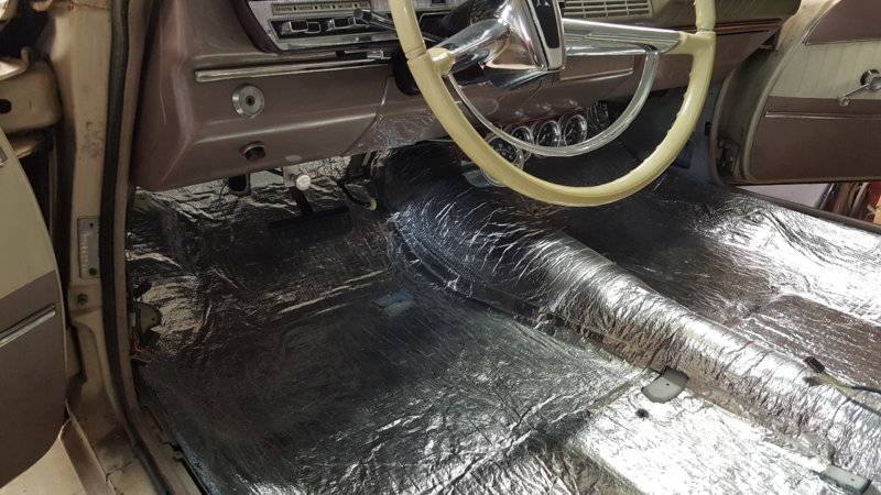

Fatmat for me! Dont remember how much I used, but I do remember I purchased a rather large roll of it and had a bit left over after doing the Newport. Note: I did not to the roof.

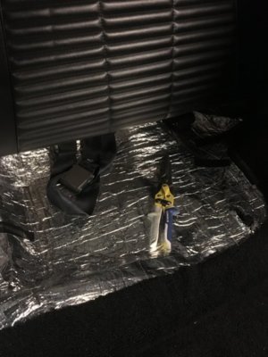

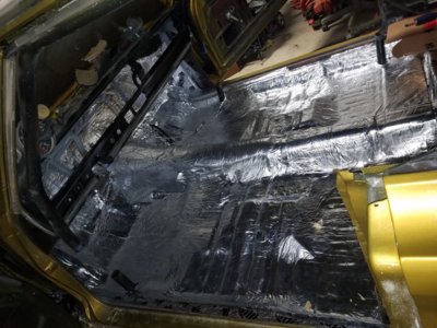

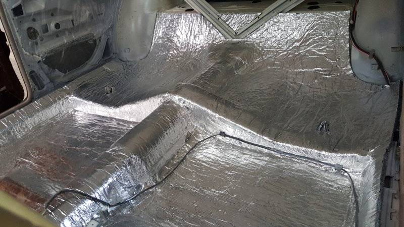

Used about 50sqft on the floor ( length x width= area). I put down Kilgimat first. It was cheaper than anything else. Then came back and rolled out some insulation like Kid did except mine had a mastic backing.It was pretty cheap off of Amazon.
