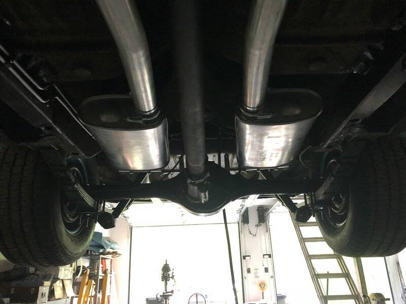

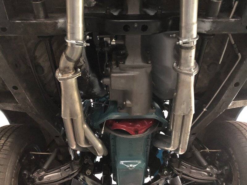

The headers are Hooker but from the headers back is TTi. These are the mufflers that come with their full 2 1/2" system.

It wasn't too bad though things like replacing an exhaust system tend to be a little easier for me since I have a lift.
Anyway, the main hassle in my case was mating the headers to the exhaust. If you use any brand other than TTi for headers, you will have to make adapters to connect the collectors to the exhaust system. TTi does provide the extra tubing in the kit to do the job, it's a matter of measuring/cutting/welding the pieces and getting them oriented right which can be a little tricky. The rest of the system fit perfect, nice and level.

That looks great! Thanks for the pics and video I really appreciate it. I think I'm going to pull the trigger on this one.
