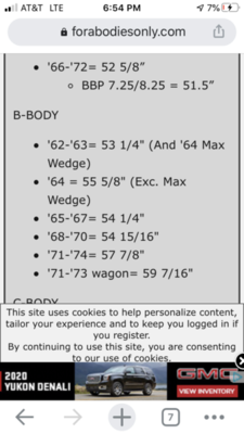

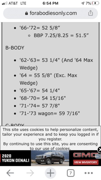

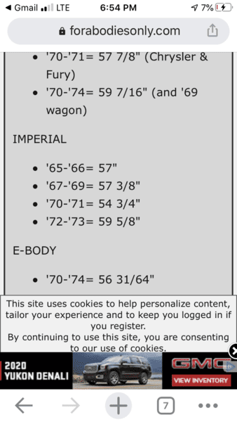

I was wondering if anyone has put a factory 71-74 e body 8 3/4 Housing under a 72 B Body. I do know I have to move the perches an I assume I have to use axles for an e body in it bc the b body axles would be too long. Would I have issues with tires or anything else?
Aren't the E body rears wider than B body rears.
I think they are shorter bc of this chart and when I tried to line up perches on leaf springs they weren’t far enough.
