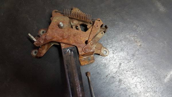

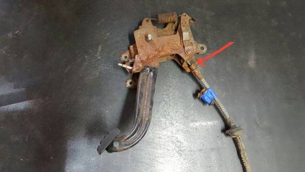

I don't know how much they changed through the years but here's a '62. (1969 owners comment on whether they use a clip)
I removed the cable from the cross member, under the car first to give the cable slack.

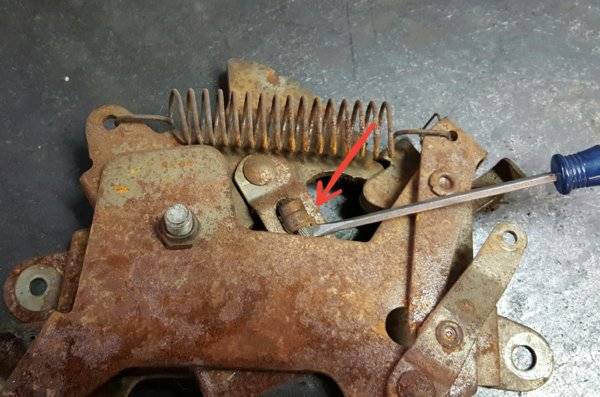

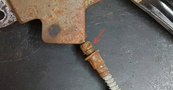

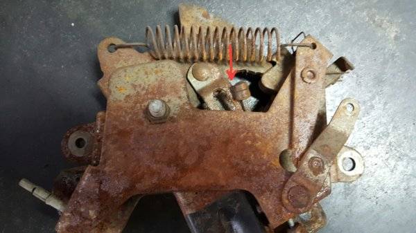

At the mechanism itself, there's not a clip but a "squeeze" type retainer that you just apply pressure while you're pulling, to release it.
Then useing a small screwdriver, pry the cable end from its seat.
Then you can pull it out.
There's a good chance that you can do this while it's still bolted to the kick panel but if it's too hard to get at, there's only three bolts to remove and your release leaver.
