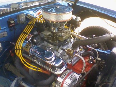

i dont have any exact numbers , but my 77 charger was an original 360 2 barrel. all i did when i rebuilt it was add a 284/480 cam , a weiand action plus 8007 intake , a holley 600 , headers and a 2500 stall converter to go with the 323 gears and it really woke mine up.
