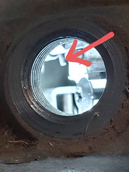

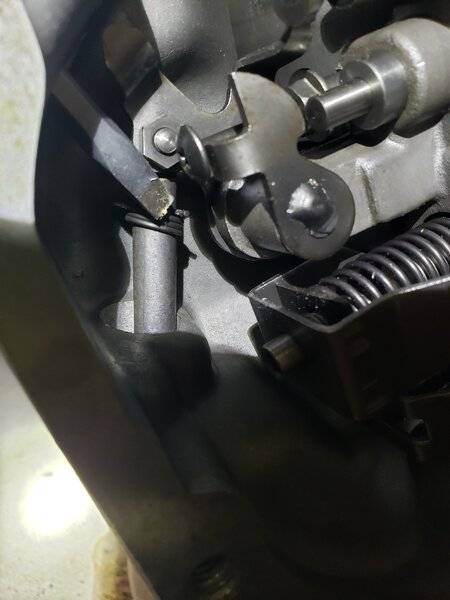

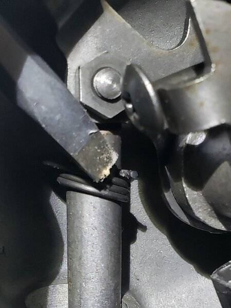

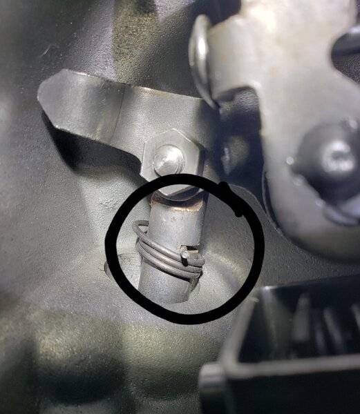

As you look through the NSS hole there is a rod attached to the rooster comb shift mechanism. On this rod is is a wound spring that holds the cable in. The spring has a nub which you press in with a screwdriver to release the cable.
View through the NSS
Looking at it from underneath if the pan was off.
Screwdriver through the NSS hole to depress it.

Pull the bolt. Pull the cable out as far as possible and up toward the trans centerline. Slide a thin straight pick in along side the lower side of the cable hole. Walk the pic around the cable. You will feel the retaining spring pictured in post #6. When you do push the pic sideways and pull the cable. It may take you a few tries but you’ll get it.
