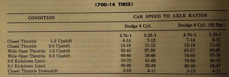

The 727 6 and 8 have kickdown but not as sensitive as the newer Torqueflights. Being just one pressure leaver it's not always possible to have a early kickdown and a good shift pattern. If you get the shift pattern adjustment on the money you'll have a noticeable kickdown but it's limited to speed. I believe there is an internal adjustment that can be made if the throttle leaver won't adjust enough. Here's the chart in the FSM.

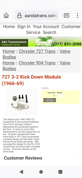

Believe you can change the valve body to the 69 and newer or when it changed over in talking with my tranny man
A&A also has a kit that says from 66-69. I haven't heard of 2040 parts before but their kit is half the price.
