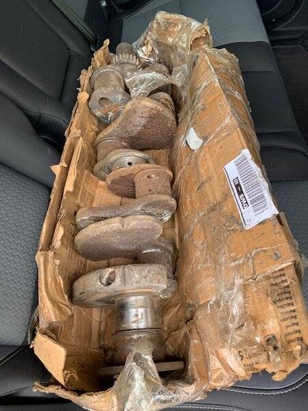

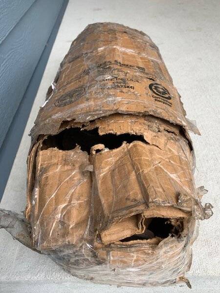

The crankshaft was originally lost by UPS and then found. It was packaged and shipped from a UPS store, and this is how it arrived! Luckily, it was all good from the speed shop......

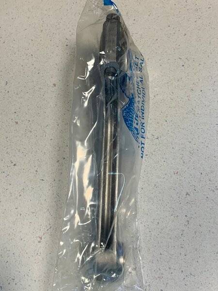

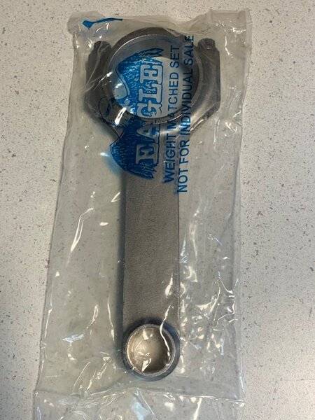

Crankshaft was a little crusty, so that's when I decided to stroke it out. Ground down the rod journals to accept BBC Rods which are cheaper and offer better sizing to more cubes! I purchased a set of Eagle Specialty 7.1 rods and will order custom pistons to get to the goal of between 451-468 CI.

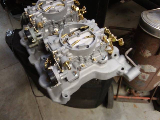

Dropping weight as well as adding horsepower is what this build is all about. Picked up a Weiand 2x4 intake with re-built carbs from the great state of Michigan last month from an old racer. Stock intake weighs about 37 lbs and the Weiand is less than half that!

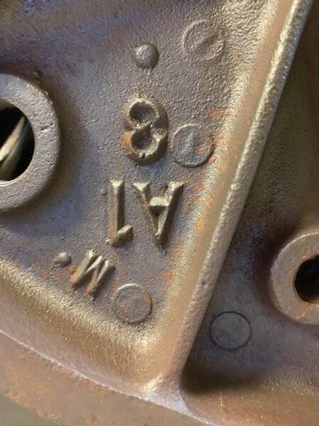

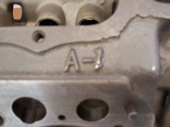

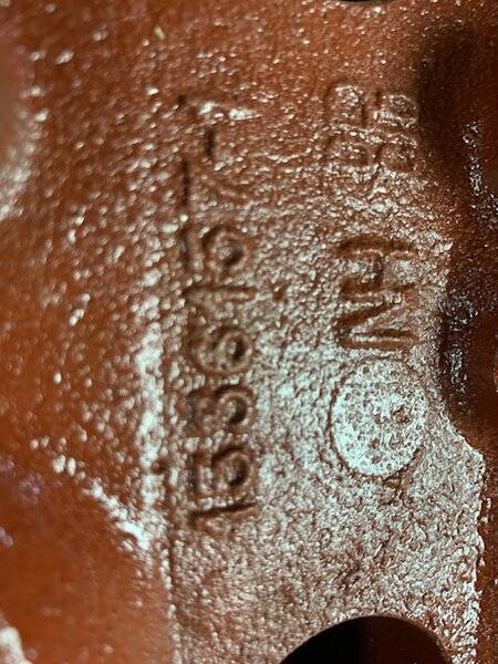

The 354 heads flow better. Get a main cap girdle. (weak spot on non deep skirt type blocks. The preferred blocks for this are the "A-1" block. Look for that casting letter next to the distributor hole in top of block. All are good but these were the best.

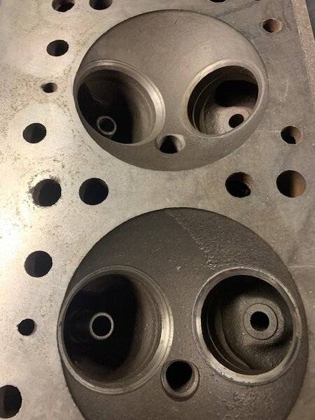

I have learned a lot about these early hemi's over the last nine months, that's for sure. Mine is the A1 block, and I have a set of the best early flowing heads in the 1955 331 "Triple Nickels" They were cut for the larger 392 valves, 2.00/1.75's !! Hemi Hot Heads has been a great help as well as other resources..............

Fantastic find. Boy those UPS guy's where rough on that package. If you went down to where they transfer every thing and watch stuff fall off the conveyer belt. Then they pick it up and toss it to the guy in the truck. Been lucky so far with part's shipped but they did destroy a pallet I had a rear end shipped to me. They just rapped it in the card board that was left. I know because the guy that sent it to me sent pic's of it before UPS got it. But very interesting motor build let us know how it turns out. :thumbsup:

Pretty rough looking combustion chamber in your picture. Lot of pitting. Standard chamber should be very smoothly machined. These engines were practically hand made and were dyno'd before installation at the factory. One of the main reasons they discontinued them. Very costly to produce.

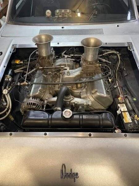

When it's all said and done, my motor will weigh LESS than a stock 440. They put these into A & B & E-Body's all the time with no issues, so I am not sure what you are talking about modifying the shock towers???]
Very cool build. My buddy put together a stock 392 once, and I always thought the rods looked rather spindly. Those rods will be a good upgrade, plus the added stroke won't hurt.:thumbsup:
I put one in an M body without much problem.
