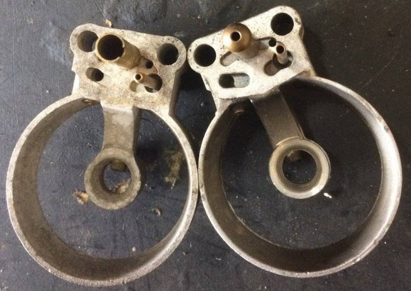

- the most likely cause. I have seen pics of some Edel 750 AFB carbs that had a bullet nose end to the sec booster emulsion tubes. These had a small hole in the end which was smaller than the sec jet & in effect became the sec met jet. Simply enlarge this hole so that it is larger than any sec jet that is likely to be used; this ensures the jet does the fuel metering, not the emul tube entrsnce hole.

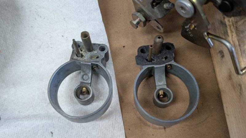

Is this the bullet nose booster your talking about? How do I enlarge? I want to be sure this is it before I make a permanent change. Also is there anything I have to do with the air bleeds if I'm enlarging the booster nozzle size?
Yes, those are the 'bullets'. Drill them out with a 1/8" drill bit. That is 0.125" & is bigger than any jet that would be used with a NA engine. The jets will control flow rate, not that hole. I have never seen an original Carter AFB with those bullet ends, do not know what Edel was thinking....

The original Carter Comp Series AFB came out in the late 60s. There were five models# 4758 to 4762, 500 to 750 cfm. All exc carbs. Modyfying the Edel carb as per post #11 will make the sec performance as good as the Comp Series. The same booster design is used.
In post #10, you can see the clever low speed start up cct that Carter used to initate sec fuel flow. It is the small brass tube in the venturi ring next to the booster leg.

Left booster is from a Carter 9000 series carb produced in the late 70s
The booster on the right is from a Weber(USA) carb

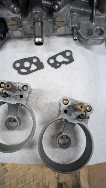

Ordered a parts 1405 for $50, read that model doesn't have the restricted secondary booster and is compatible with my 1407. Sure enough it fits, driving around it no longer is lean at WOT in fact its super rich which is what I would expect with the jetting I have in there now. Anyways I hope anyone else running in to this problem finds that useful. You can see the two boosters side by side in the photo. Thanks for all the suggestions especially @Geoff 2
