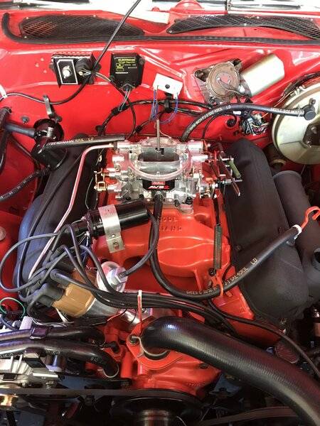

I bought the Edelbrock 800 AVS-2 for my 68 440 RT. What I thought was really strange was when I took it out of the box the F/A mixture screws were backed out as far as they would go and the accelerator pump was on the top hole. I have purchased Edelbrocks before and never seen a carb set up like this right out of the box. Everyone I have bought the F/A screws are within a turn of being closed and the accelerator pump is set in the middle hole. Anyway I put the carb on set the F/A screws set idle which was way off and go for a ride. Accelerates good jump on it and she takes right off. 65 mph let off the gas then step back on it and she hesitates so bad it was like a total dead spot but no backfire, get back home set the pump in the middle hole go for a ride same thing. I tried different metering rod spring and no matter what I do nothing changes the the hesitation. So I'm just wondering if anyone else has run into the same issue and what you did to correct the hesitation.

I ended up sending the 800 AVS-2 back to Summit for a replacement. After working with Edelbrock tech's for over a week they determined it could be a defective carb as no matter what we tried we couldn't get rid of the hesitation. I asked the tech about the F/A screws being backed all the way out and he said that's not normal so I'm wondering if the carb missed final testing before being shipped to Summit. Fast forward, I get my replacement carb from Summit ( hassle free return ) take it out of the box check it all over and the F/A screws are only backed out a turn and a half so I know I'm in better shape. First thing I did though was to pull the top of the carb off and check the floats, one was perfect the other was off quite a bit so I reset the float and put it back together and put the carb on and the only thing I had to do was set the F/A screws and they were only off a 1/4 turn, everything else was set perfect idle and fast idle for the choke. Took it for a ride and the response was so much better than the first 800. Got up to 65 let off the gas back on hard and there was a slight stumble nothing like the hard hesitation I had with the first one. Took it back home and because I have 14" of vacuum at idle I changed the orange stock springs to the pink ones, took it for a ride and she was better but not perfect. I then swapped out the stock 65/52 rods for a set of 68/47's and she is perfect, a little leaner on the primary's and richer on the secondary's. Smooth as glass I can go 65 let off the gas and back on hard and there is no stumble or hesitation at all, she runs perfect.
