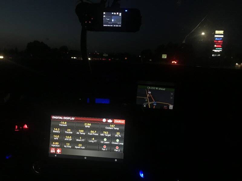

Happy numbers on EFI tablet recent romp. Pro Flo 4.
