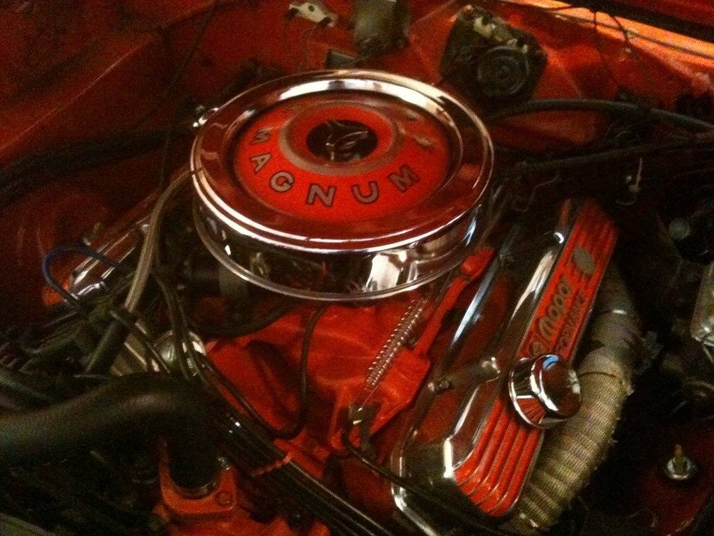

Setup, wow its been15 years since the engine was built and I hate to be a bad car guy but I forgot the compression ratio. The rest is,,,,440 , .030 over, 484/284 cam, 2500 stall converter on 727 automatic, 3:23 gears posi. stock heads, stock HP exhaust manifolds.

OH FORGOT, below is my motor specs that the new carb specs worked on.
440, +.030 over, 484/284 purple cam, 12 degrees initial, 34 total, running 2800 stall converter on 727 auto.
750 edelbrock .110 jets, 070x037 rods, with .043 accelerator pump Nozzels.
Idle RPM is 1000, idle in gear is about 900. this seems to have gotten rid of the WOT bog
