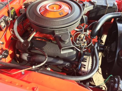

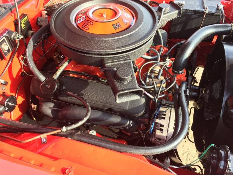

I run the E Street Heads 75cc on my 1971 383/432 Stroker with factory HP exhaust manifolds
Zero issues with spark plugs and wires
A - What pistons are in the motor now , flat tops or ? When you pull the heads measure how deep they are in the block at TDC
B - What camshaft are you running ?
59294DDF-D82B-4DAF-A414-244637893504.jpeg 42F10CE2-166A-4CFC-B110-E7B4C8427D1E.jpeg
Then a YES
View attachment 766867 View attachment 766868
