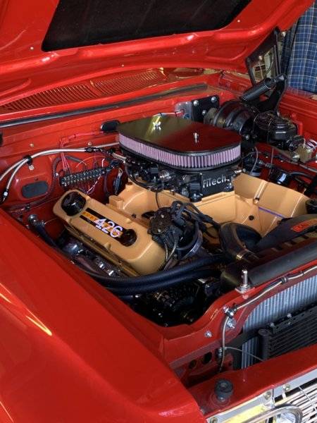

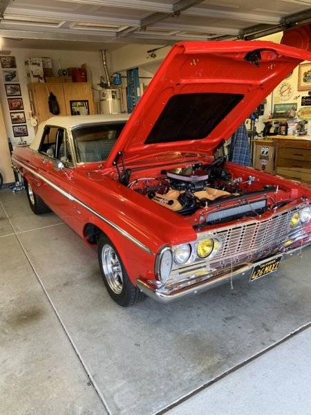

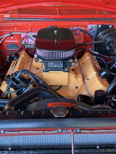

440-1 Indy aluminum heads (1/2" taller than iron heads) and Indy Modman intake with Fitech throttle bodies. Street car, so homemade air filter. 64-65 Hemi scoop. Wing nuts clear the bottom of the scoop by 1/2"!!!!
