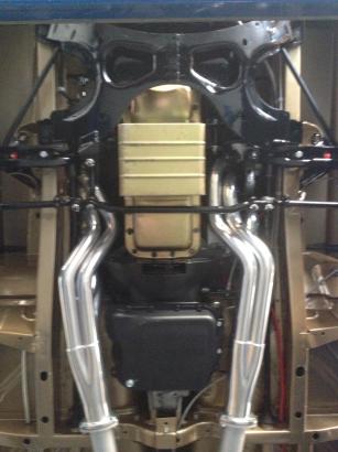

They fit fine. I have that combo on my Plymouth. I also have the newer K frame so it would be the same as yours. image.jpg
