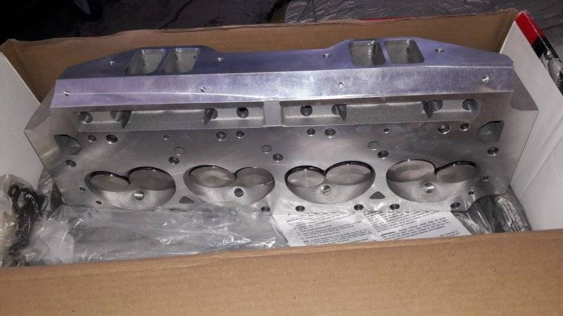

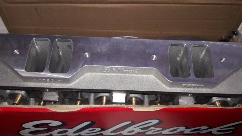

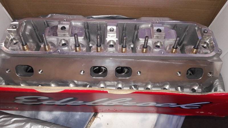

    Well I got lucky I bought a set of brand-new Victor Max wedge heads for 1100 bucks now I just got to decide whether I want to port them and polish them or just put them on received_329830594418592.jpeg received_1106473822840817.jpeg received_559648984452759.jpeg

      Good price. How did you get that deal?
      Get rocker arms. The T&D ones have a 0.725" offset intake rocker.
      Mock up the heads, and check for pushrod clearance, you might need to do some grinding for pushrod clearance, so don't assemble the heads until after checking the pushrod clearance. My heads came with valve stem seals, are these the heads that come with the Edelbrock valves, or bare heads that someone added valve to? Just curious?
      The cost of the rocker arms, valve spring seats/cups, valve springs, retainers, locks, and lash caps (if used) adds up really quick.
      If your going to run a big solid roller (over 0.700"+ lift, 700+ spring rates), look at the T&D #8244 paired 5/8" shaft rocker system.
      http://tdmach.com/product/big-block-mopar-edelbrock-440-victor-max-wedge-58-shaft-paired-system/
      I would at least gasket match the intake ports. Mine just had a rough cut at the port opening that may have been into the port 1/2"?
      Blend the bowls to valve seat inserts too.

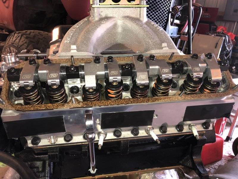

        Nice score, the t&d rockers are nice that’s what I went with. I’d you call Harland sharp they’ll make you a set of .725 offset for about $1200

        That is a smokin deal.
        They aren’t great ootb, and you should at least have the guide clearances and valve job checked.

            I picked up my t&d rockers on this forum for $1000, pretty good deal considering they are almost 1500 new

              I have the same heads. I'm running Hughes 1.6 rockers, no problems but you'll need to check / correct the pushrod clearance. Always best to have them checked over before running them. A tight guide can cause a lot of damage.

                      I run the Hughes rockers. Off the top of my head they’re .660 offset? Anyways, 2 years and no problems. No change in adjustment between maintenance. I have the 1.6 ratio on the max wedge Victor. I did have to clearance for the pushrods though.
