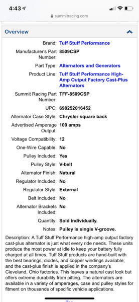

Is this the correct type replacement for my car?
Yes, that is the correct Tuff Stuff 100 amp externally regulated, isolated field, single grove pulley that would be correct for a ’70 non air application. If running an ammeter, all vehicle loads need to be on the alternator side of the ammeter. Alternator stud works fine for fans. Check voltage drop across the regulator sense lead (blue wire)and battery plus terminal. ’70 and up with column mounted ign switch Molex connectors are another weak spot for high resistance.
