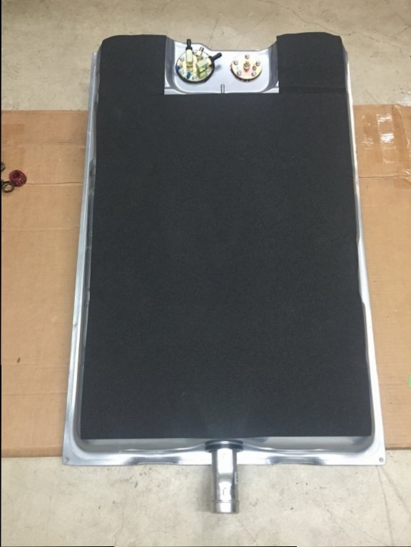

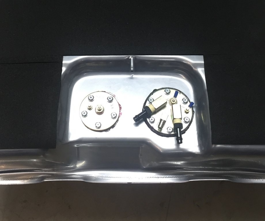

I went with tanksinc. The black is 1/8" foam I added to deaden it.

Have you installed it yet. How well does the sending unit work?
I have installed it. The sending unit seems to work fine. I mocked up a box to the size needed (same dimensions as if it were sitting in the tank) and made any necessary adjustments to the rod before installing. Also hooked it up to the wire harness to watch gauge and float position. The resistor portion of the sending unit seems to be a little stiff but I think that will loosen a bit after its fully submerged in gas. I haven't had a full tank in it yet and the resistor is at the very top.
