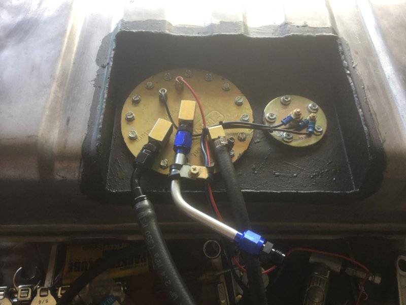

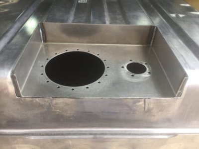

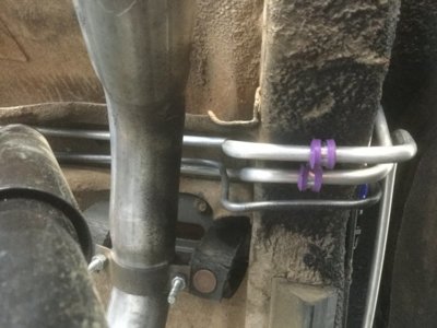

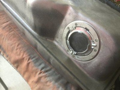

Hi everyone, I took my tank and converted it with all of tanksinc accessories. I’m not the best welder and had to fine a good welder. Here are some pics of the project. My Charger is up and running with a fitech 30003 system, dialed right in. I wished that there was a tank that had looked stock, and that’s why I chose to alter my stock tank.
