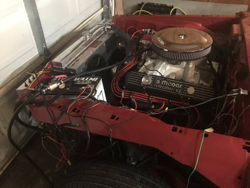

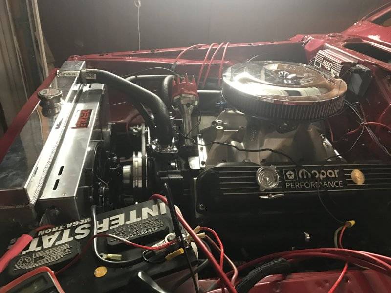

There’s very few that provides the correct CFM to properly cool a 440, I got tired of trying to find a correct belt pulley set and the after market set wouldn’t work with a Mechanical fan(didn’t find that out till after I bought it) but they look nice and have a electronic thermostat that kicks them off and on
