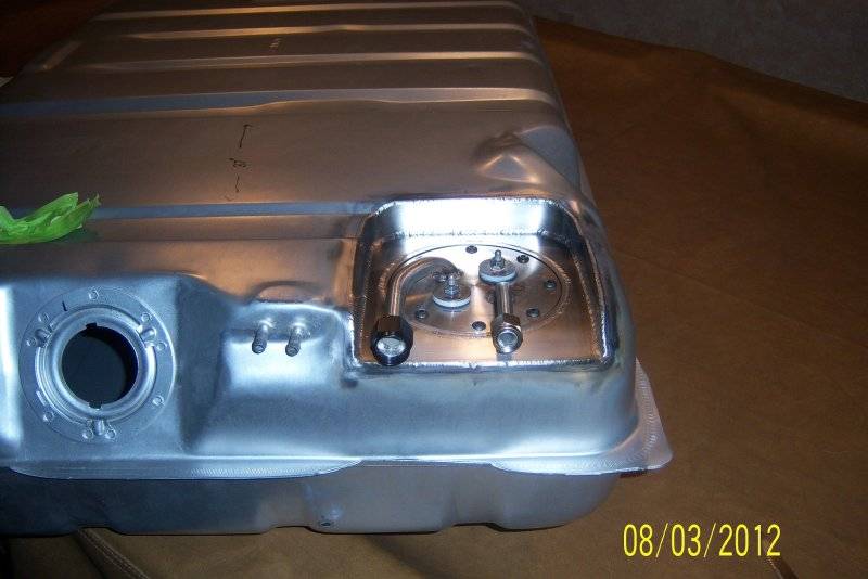

My GTX has 440/496. I run a Proform 850 double pumper. I run an in-tank aeromotive stealth 340. A new stock tank was modified to work with this pump. Regulator is Aeromotive 13204. Fuel lines are hard lines. Pressure side is 3/8 and return is 1/2. I use -6 and -8 AN fittings and hose to hook everything together. This system has been in the car for 10 years with no issues at all.
In my Charger (400/511) used a new FI tank from Tanks Inc with a Walbro 255 pump. You can get everything you need from tanks inc or just the tank and use any pump you want. The Charger has Sniper FI. Like the GTX I used hard line as much as possible. 3/8 pressure and 1/2 return with -6 and -8 AN fittings and hose to hook it all together. No issues with this system either but only got it running about 6 months ago.
If I had to do again I would not use a Tanks Inc setup. I don't like where their pump mount location is and you can only get this tank with 1/4 NPT fittings. I would modify a stock tank and use it. I'm not saying Tanks Inc sells a bad product, they offer good products and their service is excellent, but after doing both I prefer to go the other way. The picture is the tank for the GTX
When using an in-tank pump it is always better to run a return line. With a carb you should run a larger return than pressure. This is because most regulators adjust pressure on the return side. A larger line allows for more precise metering. With FI maybe not so much but I ran the larger return line on that car also.
Both of these cars make a lot of power. I have never had a fuel starvation 100_3488.JPG issue running the 3/8 pressure line

There is no fuel mat in either tank. The fuel pumps in each tank are in an enclosure to ensure positive fuel flow in various conditions such as acceleration, deceleration, turns, etc. There is no sump; The pumps are sitting on the bottom of the tank. The GTX tank has only the pump enclosure. I don't remember on the TanksInc tank. There may be a few partitions in the tank. It's advertised as a FI tank I just don't remember. I put no coating in either tank. Neither tank is stainless.
