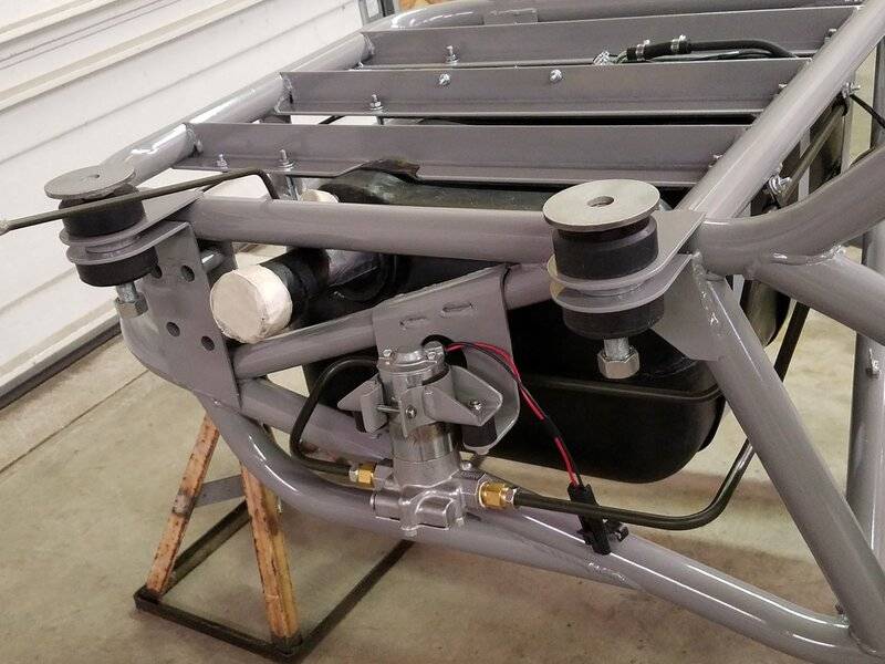

I run this one. Noise is low, flow is excellent.
Holley 12-801-1 - Holley Red Electric Fuel Pumps.
Do you have a photo of your installation? (how is the pump fed)
