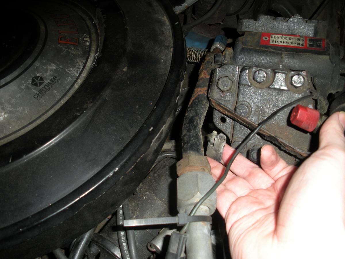

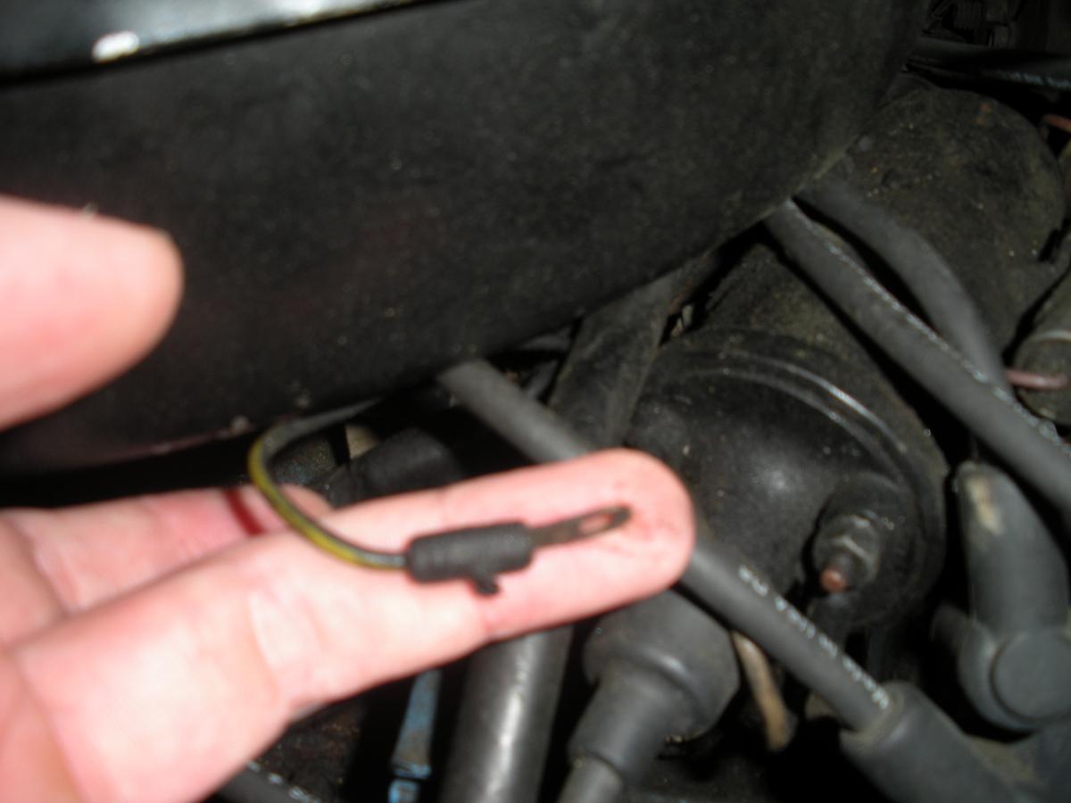

I have a 77 Cordoba 400 4BBL bone stock - with lean burn. I found these two connections that were just hanging there near the coil. the first is a ring connector that looks like it should connect directly to the coil. The other is a male/female plug that is just hanging..I couldn't find anything to connect it to. Does anyone have any idea what these connections are for?

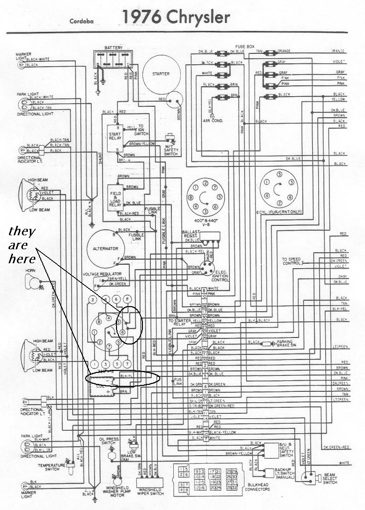

I cant seem to find the 77 but this diadram is a 76 should be very close Hope this helps you.. Ron.
first wire goes to your negative side of your coil, the second wire is to hook up to your distributor (now if its from your distributor.. it attaches to an identical connector that is on your wiring harness and lead to your ECU)

the second wire looks like it is coming from the a/c for the fan clutch.
the black wire "above" his hand is the A/C compressor clutch wire.. the one in between his fingers are either "to" or "from" his distributor
