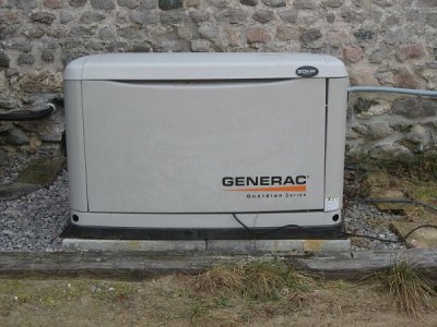

i took another route and put in a generator, propane fired as the whole house is propane. i fire it up 2-3 times a month and let it run at the peak pricing periods but it will come on auto with hydro out. house is 200 watt service and generator is 100 watt. i wouldn't want to weld and have stove or dryer on at same time. other than that it does the whole joint and as mentioned liquid fuel is cheap. good luck with you choice but if the poop hits the fan and its not approved you will have no insurance, at least here anyway.:eusa_think:
